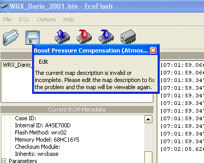

Postby impensabile » Mon Jun 26, 2006 6:27 am
excused my English. this is what it says the program to me is does not find the maps
impensabile
Joined: Mon May 22, 2006 9:07 pm
Postby NeverLies » Mon Jun 26, 2006 7:34 am
You need to get the correct XML file for your ECU or you won't be able to edit your map.
Have a look for XMLWrite on this forum ;)

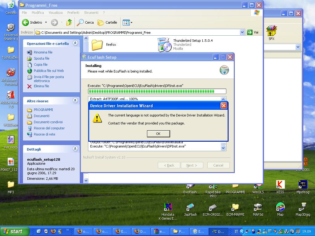

Postby impensabile » Mon Jun 26, 2006 9:14 am
this is an error in installation is normal?
impensabile
Postby NeverLies » Mon Jun 26, 2006 10:35 am
Don't care ;) Must consider this as information and not error.
Postby JRSCCivic98 » Mon Jun 26, 2006 12:52 pm
That's because the driver install was written for English... and his "Regional Settings" are obviously not English.
Postby cboles » Mon Jun 26, 2006 3:21 pm
Does the driver installation continue after this, or abort?

Postby NeverLies » Tue Jun 27, 2006 12:44 am
Colby:
I have the same error (Regional settings not set to English) and I confirm that installation is going on ;)
impensabile:
As stated above, have a look for XMLWrite here. All XML definitions files are not yet packaged with the software ;)
