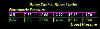

Postby qoncept » Fri Feb 10, 2006 12:28 pm
Xmicho, what software were you using to tune? Are the boost limit axis values updateable or are they static? If they're static that would explain why Andrew can't find them in the rom.
Postby qoncept » Thu Feb 16, 2006 2:34 pm
Not sure if this will help, but here's a screenshot.. I was hoping to get a screen of a stock map, but this will have to do -- I'd assume the barometic pressure probably uses the same calculation method as boost pressure and it probabaly hasn't been changed from the original values.
Edit: If my assumptions are correct, you should be looking for the following hex values:
00 37 00 3F 00 47 00 4F 00 47 00 5F
Edit: Looks like my rounding is a bit off.. it should be 00 38 00 40 00 48... which makes it exactly the same as every RPM axis in the image, and none of them are where you'd hope. :\ If nothing else, we can at least enter these in as static values in Enginuity.
