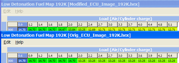

Is it normal for a modified map to alter the x-axis column data? In the example below of a standard and modified Low Det Fuel map you can clearly see that the Load Values are scaled differently. It seems more focused on higher loads than the original. Is this normal? Also I've seen this for other maps also.

Postby Freon » Fri Jan 20, 2006 7:04 pm
I would think so, because a modified map for higher boost should handle higher airflow.
Postby epifan » Sat Jan 21, 2006 12:51 am
Freon wrote:I would think so, because a modified map for higher boost should handle higher airflow.
Yes, this is first step of ECU tuning for modded exhaust or/and intake or raised boost

Postby Xmicho » Sat Jan 21, 2006 3:43 am
Double confirm that. E****k software has provisions for altering the row and column header values to reflect higher tune. For e.g. the stock fuel maps on my WRX only go to 4.2g load. However, it's not uncommon for tuned cars to see 4.6 or more so changing the axis values makes sense. I've also done this with ecuEdit.

Postby Mo » Sat Jan 21, 2006 2:07 pm
Steve do you know the source of the map?
Usually the scale will be altered after changes to the induction tract where it may skew maf values, I didn't think it's change for raising boost alone.

Postby Freon » Sat Jan 21, 2006 3:23 pm
If you have MAF skew, I think it would make infinitely more sense to fix MAF scaling so you had as little fuel trim compensation as possible.
Change the axis on your fueling map will not fix erratic fuel trims.

Postby Freon » Sun Jan 22, 2006 11:35 am
The precise reason you want higher scaling numbers is to handle higher total airflow.
If the stock map X-axis only goes up to something like 4.6g/s/cyl, and you are running an extra 3-4psi, better intercooler, downpipe, etc, you may actually see 5.5g/s/cyl or higher. While the stock map would technically work, you would have no "resolution" above 4.6. The 4.6 column would handle everything above. So you have to run the same target AF at 4.6 and 5.5 since you don't have multiple columns. In reality, you may want to run different values at these flowrates.
At low flowrates, you probably don't need as much resolution for fuel, since you are mostly just targeting 14.7:1. No need to have 5 columns all filled with 14.7 when just 2 columns is enough.
Unfortunately you can't just add columns, you have to rescale them. If its an 10x10 map, you can't make it 12x10 and just "tack on" more high flow rates at the right side of the map.
Postby crispyduck » Sun Jan 22, 2006 12:33 pm
Freon, Mo,
Thank you both for taking the time to share your knowledge. Very interesting the more I dig. So scaling now understood, I can see from my logs that my car pulls a max of 4.7g on WOT. In the illustration I provided above this would run me off the end the map, but not the modified map as that caters for 5.1g :-)

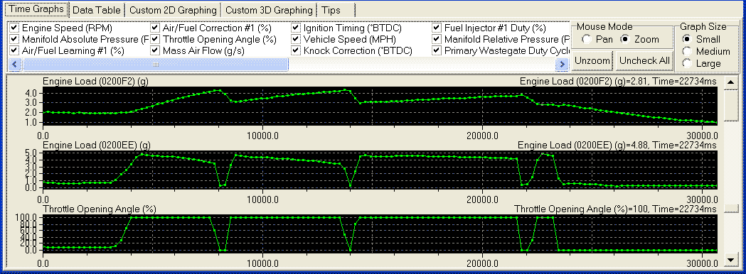

I would like to confirm with you guys that I am looking at the correct 'load' values. Basically I 'activated' all 'load' items in ecuExplorer to determine which ones moved when I blipped the throttle. The attached figure illustrates the only two load values that altered. This is a WOT run starting from 2nd gear, changing to 3rd, 4th and short 5th. Perhaps from the illustration you can confirm the load looks like its the second one as it alters when I change gear (see throttle opening) for timings?
If so then on this run I got 4.88g. Perhaps this is not correct and it's the other one. Anyway I'm sure you guys can tell from the graph profile.
