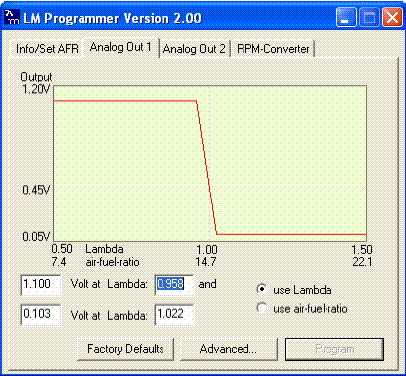

Does the LC-1 have a programmable output voltage like the LM-1? If so, you should be able to just replace the stock sensor and log in Tari. This is what I was hoping to do.. which reminds me. What is the output range of this sensor?
Edit: the rear o2 sensor..
Edit again: I don't know a whole lot about it.. but would it be possible to have the ECU control a wideband o2 sensor (so we could go buy the Bosch sensor instead of an LM-1 or another controller) ? Basically all it does is heat it sensor, which the ECU does for the stock sensor, right?

The LM-1 has a (2 wire) aux out with a configurable voltage. So I think it'd be easy enough to set it to the proper voltage range and wire it in place of the stock rear sensor.
