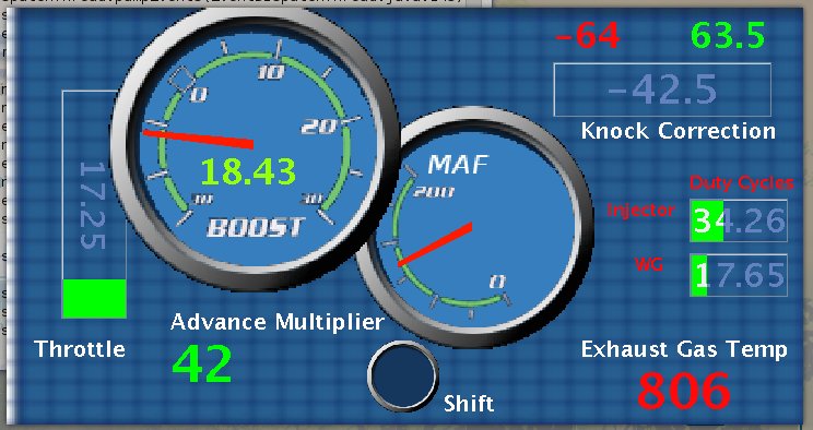

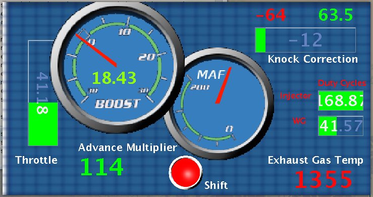

OK, a little more detail. I've added a parameter to display boost in bar as requested, still working on a better solution for unit conversion but at least you have the option now. I've also added Injector pulse/ duty cycle as requested. At some point I'll stop being lazy and add all of the parameters, it's not hard just tedious and I'd rather spend the little time I have to work on this on adding new, cool features. If there's a parameter you really want just let me know and I'll add it right away.
I've also added two new display types. I've added max and min labels which work like the old labels but display the maximum or minimum of a parameter. The other display type switches between two images when a parameter goes above or below a certain value (ie. warning and shift lights). You can also now configure display layering, ie. which displays are drawn on top of other displays.
A given parameter can also have multiple displays attached to it now. So for example you can have your standard boost gauge but also peak boost labels and an overboost warning light all running at the same time.
I think that's pretty much it for now. I'll probably release this much after I whip up a skin to show off the new features.

Postby neutronium » Wed Aug 30, 2006 9:05 pm
OK, here's some shots of the new features. You can see the shift light off in one pic and on in the other. This happens when RPMs go over 6k. You can also see the maximum boost reached displayed on the boost gauge and min and max values for knock correction displayed above the bar. I made this in like 15 minutes so be gentle :)
I've also tweaked the repainting code a bit so this version actually runs faster than the old version.

I downloaded the file on page 1, and I think I've gotten it to the point where it's gonna work (went through the various sub-program installation routines detailed on page 4, and also changed IAM address to match that of my ECU) tomorrow AM when I hook it up to my '05 Legacy 2.5GT (USDM 5MT).
So if I'm reading the last two posts above correctly, neutronium, the last two pictured screen-shots are not yet available for download as an active digital dash, correct? You're just giving us an idea of what's to come, right?

Postby neutronium » Tue Sep 05, 2006 6:21 am
Yep, that's right. I should have the new version out in the next couple days though. Hope you like it. Let me know if you have any problems.

Postby neutronium » Mon Oct 02, 2006 12:14 am
OK, I couldn't keep you guys waiting any longer so I uploaded a snapshot build while I work on new features. It's basically the one I posted screenshots of a few posts ago. Just check out the new Demo skin for examples of the new features. I haven't actually tested this build in my car but it should work. Let me know if it doesn't.
