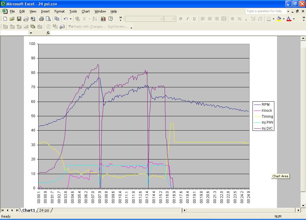

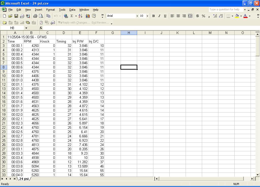

Postby danl » Fri Jul 07, 2006 2:50 pm
Here is the way most DSM loggers organize the information. I've also included a graph made by just opening the data up in excel and creating a graph real quick. As you can see, if you organize it in this way people can simply open up their favorite spreadsheet and make their own graphs. No need for a seperate log viewer. Also, you can copy and paste the data on BBS and visually to a human even the raw data is extremly useful.
Also note that my injector PW was capping out as I raised the boost past 24psi. This is a problem in the DSM code that was meant as a saftey feture. Unfortunatley it will blow up a motor if not removed. This is something for the coders of ecuedit to notice!
