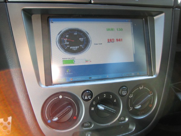

Postby megafrenzy » Fri Nov 04, 2005 9:58 am
For your reference, here is what it looks like in my car.
My resolution is 800x600.
Sorry about the glare.

Postby neutronium » Fri Nov 04, 2005 10:04 am
Thanks for the picture, that will help me get a feel for the scale. Do you think the boost gauge is an acceptable size? It's kind of tricky because if it gets too big, the cpu usage will skyrocket so I want to make sure I can keep it readable without it being to large.
Also, you said you're running an M10000 right? What's your average cpu load while the program is running?

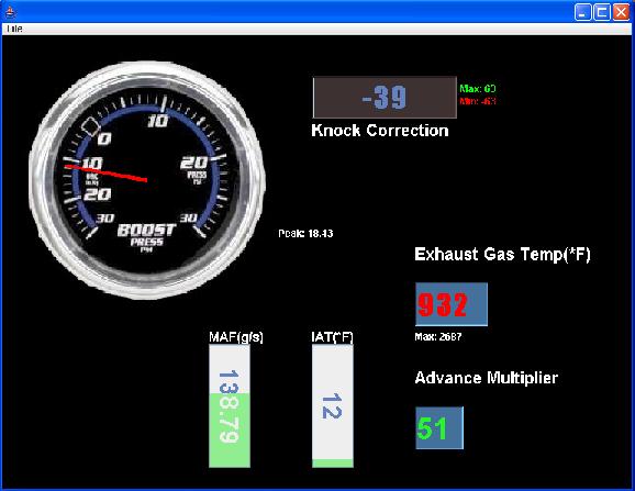

Postby neutronium » Fri Nov 04, 2005 10:17 am
Here's a pic of a few quick changes I made to the color sceme. What do you guys think? Do you prefer this one or the old one?

Postby cdvma » Fri Nov 04, 2005 11:48 am
Is that a real screenshot? Your data is really wrong if you have an IAM of > 16.

Postby megafrenzy » Fri Nov 04, 2005 3:06 pm
The gauge size is good, I would like a little more contrast with the needle and perhaps a thicker needle also. I like the black background, keeps my face from glowing at night.
Font size used on the IAM and EGT is about the minimum (as shown in my photo).
Also, its a widescreen LCD and my mobo cannot generate the native LCD size of 800x484, so its getting squeezed vertically from 800x600. That means your circles will be slightly oval on my LCD. Full screen window at 800x600 would be nice.
I typically run FrodoPlayer as my front end, which plays the mp3s using winamp. If I'm navigating, then I also have iGuidance. I'm not sure about the CPU load, but its not much. I'll check it out on my ride home tonight.

Postby neutronium » Fri Nov 04, 2005 9:14 pm
LOL no, those aren't real values. I hope I wouldn't have knock correction of -39.
