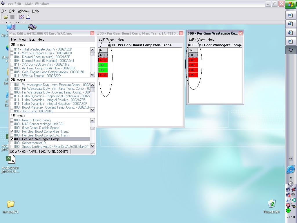

Postby Spec C Wannabe » Wed Jun 14, 2006 6:56 am
In my MY03 EURO WRX,I found this feature (Per Gear Boost/Wastegate Duty Compensation) in my rom image by looking through EcuEdit but I'm not sure if the table is oriented in 1-2-3-4-5 top to bottom or the other way around. In the standard rom, it listed the value as -17, -17, 0, 0, -17 from top to bottom which make me curious on how the table is oriented. Why reduce boost both in 1st and 5th ??
Per Gear Boost and WGD Compensation Table
Per Gear Comp.JPG (98.16 KiB) Viewed 16811 times

Postby west_minist » Wed Jun 14, 2006 7:00 am
reduce tranny stress in 1 and reduce overboost in 5
Postby Spec C Wannabe » Wed Jun 14, 2006 11:34 pm
So do you think the table reads 1-5 from to bottom or vice versa?
Spec C Wannabe
Posts: 59
Postby west_minist » Wed Jun 14, 2006 11:46 pm
Looking @ it, it makes sense from top down.
I have 2 sti's I am tuning, but one haven't start yet. But the other one, I am waiting feedback on that tune with those params. (Per gear boost/wg).
I also notices in ecuedit "Boost 70 70 70". The map also looks interesting, but no results from test yet.
Postby Spec C Wannabe » Thu Jun 15, 2006 12:14 am
Thanks for your reply. From what you said, you've already changed these params already in one of your STIs. What changes have you made to these tables? And how were the outcomes?
It seems to me that it is impossible to get the boost right for every gear by changing only WGD Min Max and Boost Target tables. If the boost comes right in the 4th and 5th, it will undershoot in 1st and 2nd or the the other way around. There are always tradeoffs.
Is it possible to get 1.2 max in each and every gear?
