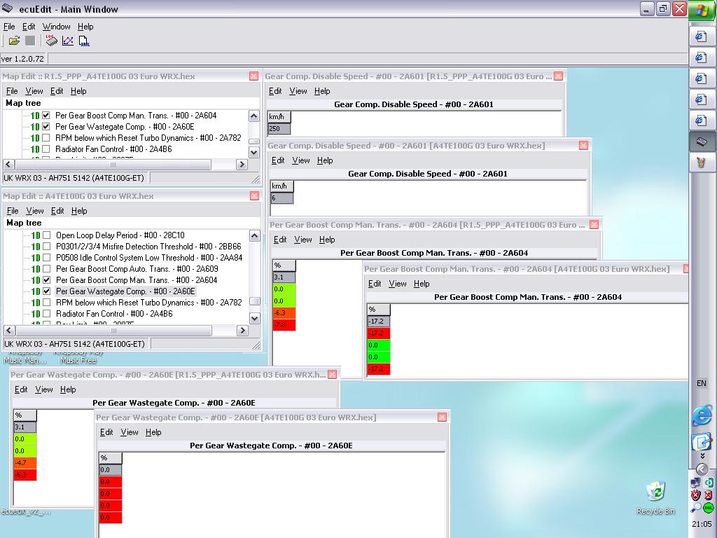

Postby Spec C Wannabe » Sun Aug 06, 2006 5:20 am
Ok Guys, I have exploited the Per Gear Boost and Wastegate successfully.
I've come to a conclusion that the gear ratios from 1st to 5th are oriented from Top to Bottom (EcuEdit) or Left to Right (Enginuity) respectively. Using the rule of elimination, I've figured this out by changing the top row of Per Gear Boost Comp. and Per Gear Wastegate Comp. to -99% while leaving the remaining cells to zero. At my several attempts, I monitored Primary Wastegate Duty of each gear and found out that this parameter became zero while those of other gears showed the expected activity of Boost Solenoid. :D
At the very first attempt, the experiment failed and showed no difference in Wastegate duty. Not giving up, I searched more and found another gear-related table called "Gear Comp Disable Speed". This table can only be found in EcuEdit using XMLwrite generated definition. The factory setting was 6 km/hr, so I guessed the Per Gear Boost and Wastegate Comp were disabled beyond this speed limit. I searched more into JDM STI and found out that this table was set at 250 Km/hr so I changed mine accordingly. Since then, these Per Gear Compensation function as they are supposed to :D
For those of you whose ECU have these features, be sure to raise the Gear Comp Disable Speed to the max. These features work very well with my car and now I'm very pleased with the result :D
see my setting
Gear Comp Disable Speed Table.JPG (129.28 KiB) Viewed 11567 times
Spec C Wannabe
Posts: 59
