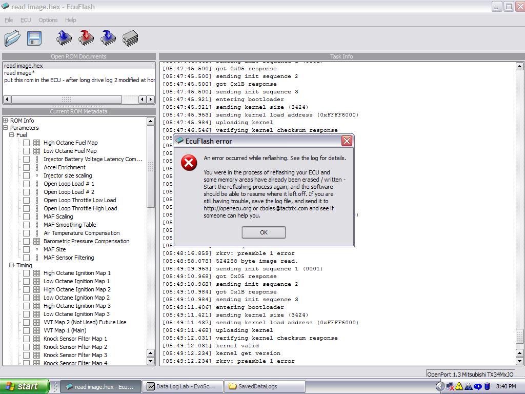

Postby alwaysinboost » Sun Oct 29, 2006 4:56 am
yeah I guess that would help, here is a screen shot of the error.

Postby laakness » Wed Nov 01, 2006 3:00 pm
As we talked about on Evom...and even though you don't have a mini battery...have you tried hooking up a battery charger to the car and shutting off all other electronics/lights.
That's what worked for me.

Postby alwaysinboost » Wed Nov 01, 2006 4:59 pm
I didn't try the battery charger thing but there wasn't any accessories on at the time. I don't know why it would D/L the ROM with no problem on both cars and then not reflash on both cars. I really don't think its a voltage issue.
