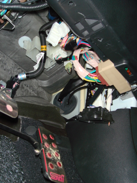

Postby sevenphotos » Sun Oct 01, 2006 8:14 pm
Replied in to your pm, but thought it would be a good idea to repeat it here. Next to the accelerator pedal, on the right side of the footwell is a panel that can be popped off. There is cables underneath there, and there is a pair of unconnected white blocks. You need to connect those blocks together to put the car fully into test mode and to be able to write to the ECU.
sevenphotos
Joined: Wed Jul 05, 2006 3:18 am
Postby LGTspore » Mon Oct 02, 2006 6:36 am
Cool!
Here's the photo that sevenphotos is referring to...
I'm going to try this as soon as I can!
Thks again mate!
