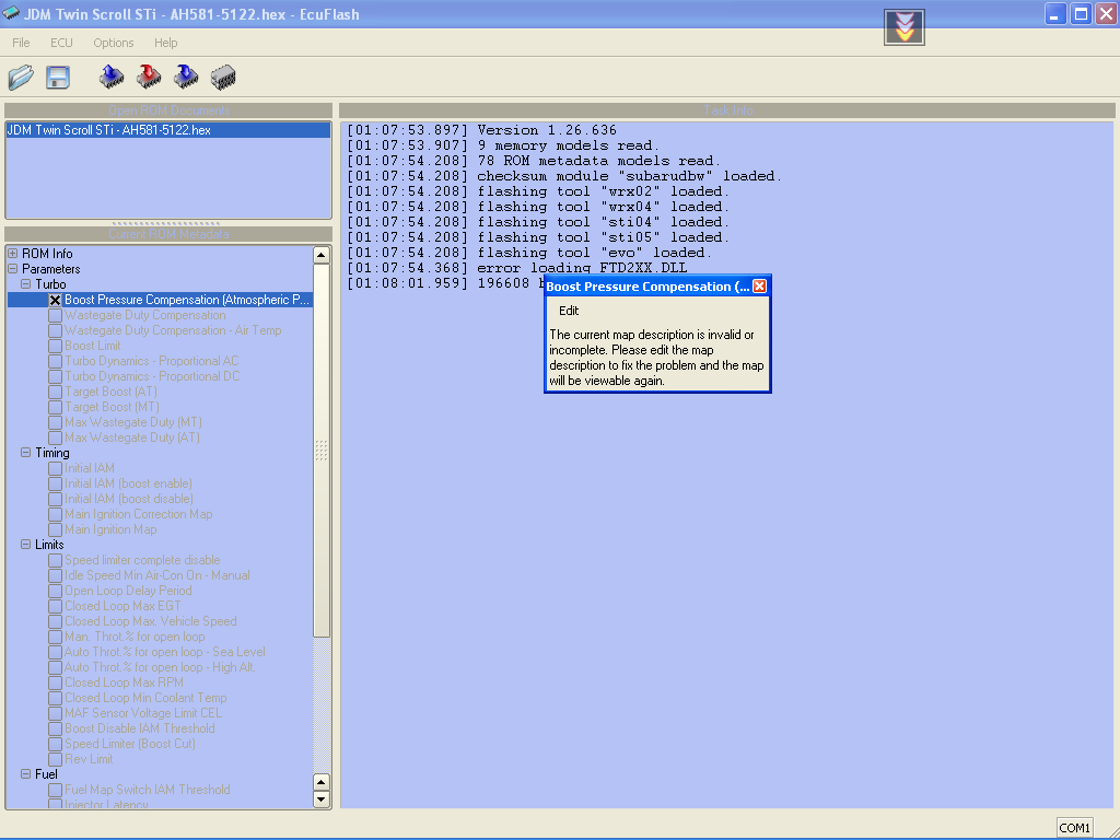

I cannot open save roms with this software.
Is there a reason for that?

Do you have an XML definitions file for it? Please post your ROM, year make and model and whichever Def file you are using.

I can open the roms and the definitions come down, but gets an error.

Post your ROM and I'll make a DEF for it. You are using A4TE002B.

It also appears not to work with the Evo 7 files posted in the Evo forum.
http://forums.openecu.org/viewtopic.php?t=277 (EM9986)
It did however open the Evo 8 file I tried.

Here you go. Use XMLWrite on any ROM that doesn't have a valid XML file.

There is an error with XMLWrite v5 and the a4te002b "desired boost auto", rpm row settings.
Should start at "2a9a9" and power = 2 byte, right now it says "2a9be" and power = 1 byte.
I just edited manually edited my xml to work correctly.

I get the same error no matter what using a map that I have flashed and run on cars before.

Tried lots of roms now. Same error on any checkbox.

Wierd. Loaded the rom from my car. I've never been able to open it. It worked, but Wastegate Duty Compensation still gives the error.
