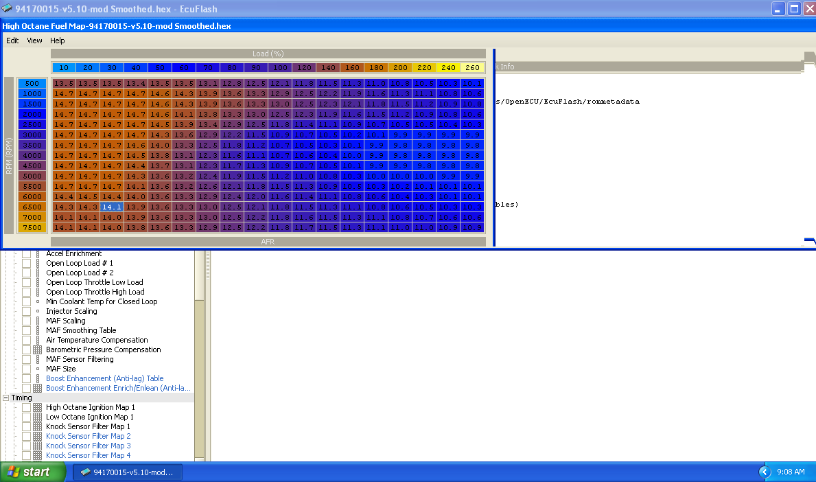

I'm not able to view a graph of my fuel or timing tables. It looks as though I tries to load he graph but than freezes as the box is transparent, meaning portions of the ROM download is visible in the graph box?
I'm running ECUFlash via Parallels thru MAC OSX. Suggestions?

Well I downloaded v1.34 for MAC and I am now able to view the tables in a graph form but, v1.35 should still work inside Parallels given it is setup using a virtual machine via Parallels, running off its on OS?
Still would like some help to get this working properly in Parallels since all my other ECU programs are running in there.

I'm still having difficulty viewing graphs in v1.35 through Parallels. I've attached a screen shot for anyone that can help.
I've downloaded DirectX from Microsoft but, to no avail. Check out the attachment for a better view of what's going on. v1.34 again works fine on the MAC OS. Note how the graph box appears transparent (?).

I have fixed the OSX 10.5 problems with OpenPort 1.2 and 1.3 cables. There is a EcuFlash 1.38 version you can download now that should work.
