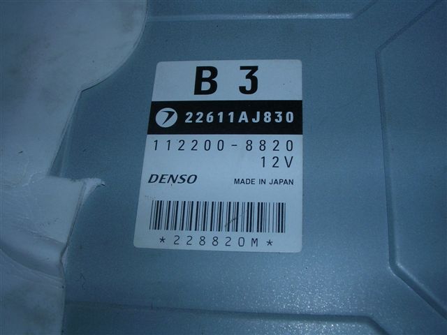

My name is avihai topor and I live in Israel
I am trying to read some ecus with ecuflash 1.35 and with ecuexplorer
This is the ecu number of a 2005 2L wrx
B3
22611aj830
112200-8820
12v
Denso
#228820m#
I am using tactrix openport universal for Mitsubishi and Subaru
What kind of ecu is it? Usdm jpdm audm sadm eudm
Can you help my with some info how to get it work ok
2005 WRX ECU

Postby christian_piasini » Tue Jun 17, 2008 11:25 am
Hello Avihai topor,
maybe you remember me, I'm Christian Piasini from Piasiniengineering Italy
here the details you are looking for :
Tipo MCU : HC16 160kb flash
Marca auto : SUBARU IMPREZA 2.0 TURBO WRX '05
Marca centralina : DENSO
NO centralina : 6C / 22611AJ830-8820/ 112200-5141 / 12V /
The ecu is an WRX European model 2.0L 218HP.
Hope to hear from you soon.

Postby radsdau » Tue Jun 17, 2008 3:20 pm
Yes; use the WRX01/03 hookup method to start with. If you have no luck, try the WRX04/5 method, but this seems to only apply to US models.
Make sure the green test mode connectors under the dash are connected. You will also need the flash jumper block attached for reflashing (4-way or 6-way connector, under dash, near test mode connectors).
