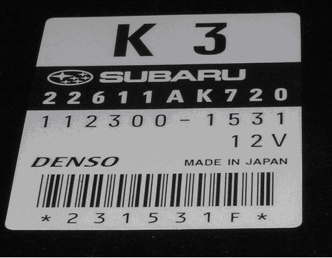

The Label of the ECU is showed bellow and the the contents of the log file as here:
The Version of My FXT's ECU, From P.R.China.
ECU Version of Forester 2.5XT.JPG (25.93 KiB) Viewed 3613 times

Your ECU is the same as the one used in Europe for the 2006 Forester XT automatic transmission. Its calibration ID is A8DH100P and it is supported by the Enginuity ROM editor at http://www.enginuity.org.
