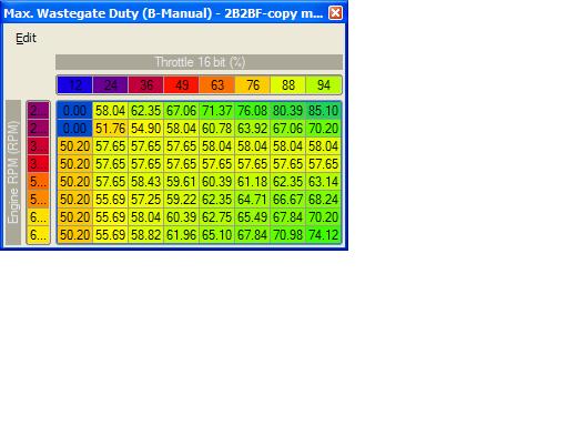

Postby New2Scoobs » Tue May 16, 2006 1:53 am
Colby, V1.27 is a marked improvement over 1.26 in terms of displaying the data in the maps but there still appears to be an issue with the width of the "RPM" column. See below.
Postby nv-wrx » Wed Jun 14, 2006 11:32 am
I had that problem. Exiting ECUFlash and re-opening it seemed to fix it.
