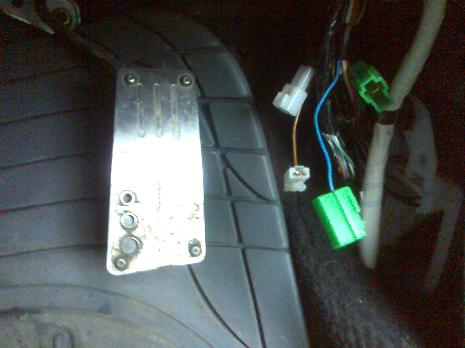

Postby in1t » Tue Aug 05, 2008 6:49 pm
Problem is solved!! There are additional green test mode connectors on LGT JDM, it's located behind kick panel on the driver side, right from the accelerator pedal. After connection those and two on the passenger side the test mode goes ON! I have read my ECU rom using WRX STI 04 method. Thanks all for the help!

Postby BoxerFan » Fri Aug 08, 2008 7:53 pm
Photos?

Postby eminehart » Tue Sep 09, 2008 8:41 pm
That is where the extra set is on Left Hand Drive models only it's behind the PASSENGER kick panel. The Right side of the vehicle. All the subarus i've seen have 2 connectors wired in series.

Postby in1t » Wed Sep 10, 2008 5:21 am
here is photo
