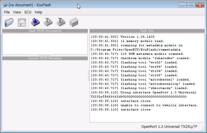

Postby nakagamawa » Thu May 08, 2008 1:16 pm
1,When using My Openport 1.3U cable, EcuFlash LOG is ...
[22:54:48.149] Version 1.34.1435
[22:54:48.165] 11 memory models read.
[22:54:48.165] scanning for metadata models in C:/Program Files/OpenECU/EcuFlash/rommetadata
[22:54:50.676] 220 ROM metadata models scanned.
[22:54:50.676] checksum module "subarudbw" loaded.
[22:54:50.676] flashing tool "wrx02" loaded.
[22:54:50.676] flashing tool "wrx04" loaded.
[22:54:50.676] flashing tool "sti04" loaded.
[22:54:50.676] flashing tool "sti05" loaded.
[22:54:50.676] flashing tool "mitsukernel" loaded.
[22:54:50.676] flashing tool "mitsukernelocp" loaded.
[22:54:50.676] flashing tool "shbootmode" loaded.
[22:55:27.024] Using interface OpenPort 1.3 Subaru TX47kC2u5e2975dd00000000000000000000000000000000
[22:55:27.024] interface close
[22:55:27.040] unable to connect to vehicle interface.
[22:55:27.040] interface close
2,When using Tactrix Openport1.3U cabe ,ECUFlash log is..
[23:02:21.762] Using interface OpenPort 1.3 Subaru TX47kC2ucfacb4d9e11668e28485f309b57cbd6c7aafe5f4
3,Question
What' wrong?
I can't make same eeprom data of FTDI232R(of my cable) by Mprog3.0 as TACTRIX's data.How do I make same eeprom data?[/img]

Postby nakagamawa » Sun May 18, 2008 4:54 am
[quote="BoxerFan"]Try downgrading to ecuflash 1.29.[/quote]
Thank you.
I got EcuFlash 1.28,and I confirm.
[01:00:55.509] Version 1.28.716
[01:00:55.524] 8 memory models read.
[01:00:56.195] 71 ROM metadata models read.
[01:00:56.195] checksum module "subarudbw" loaded.
[01:00:56.195] flashing tool "wrx02" loaded.
[01:00:56.195] flashing tool "wrx04" loaded.
[01:00:56.195] flashing tool "sti04" loaded.
[01:00:56.195] flashing tool "sti05" loaded.
[01:00:56.195] flashing tool "mitsukernel" loaded.
[01:00:56.195] flashing tool "mitsukernelocp" loaded.
[01:00:56.195] flashing tool "mitsubootloader" loaded.
[01:01:29.392] ssm2_init
[01:01:29.579] ssm2_init
[01:01:29.782] ssm2_init
[01:01:29.985] ssm2_init
[01:01:30.188] ssm2_init
[01:01:30.390] ssm2_init
[01:01:30.578] ssm2_init
[01:01:30.796] ssm2_init
[01:01:30.999] ssm2_init
[01:01:31.186] ssm2_init
[01:01:31.545] kernel get version
[01:01:32.060] validating denso kernel ram area addr: FFFF6000 len: 0008
I found My cable response(log) is same as Tactrix's response(log).
