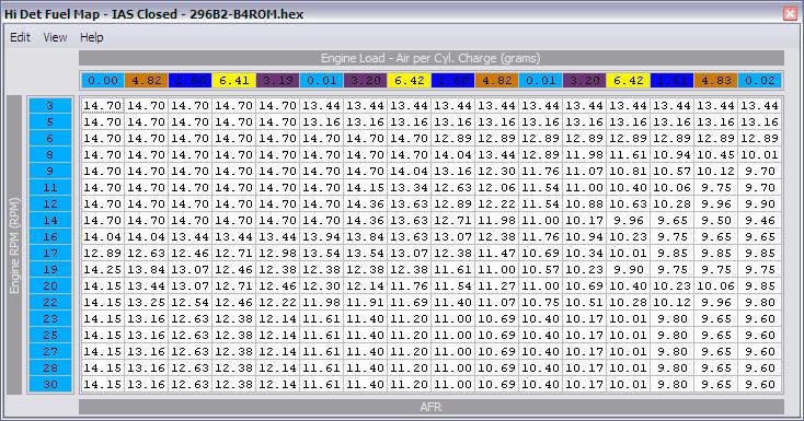

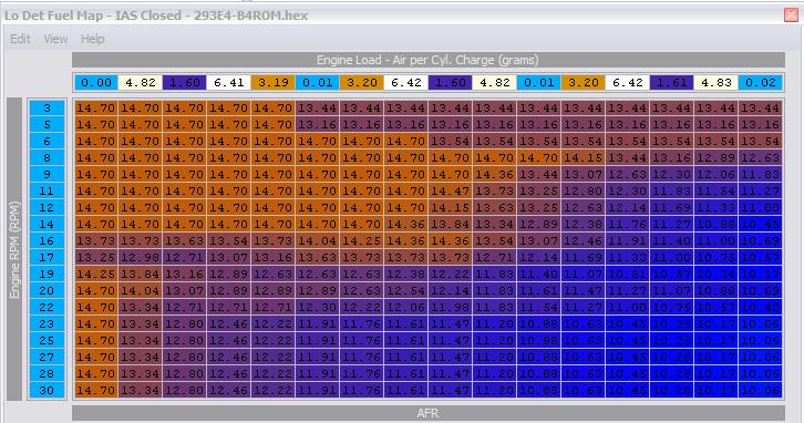

I'm facing issues with the current XML definition not being displayed properly in ECUFlash 1.3.1 onwards.

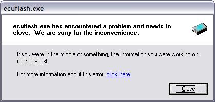

For example, the low det fuel and high det fuel is not displaying properly. If you select the injector flow scaling, the entire ECUFLASH crashed. There are others as well.

High Det Fuel
Low Det Fuel
Injector Flow Scaling

That's mitsu definitions which wouldn't have anything to do with the Subaru update. The endian attribute was fixed starting with Ecuflash 1.31. If you read the change list you'll see that it is not compatible with older definitions. You can fix this by going into the base xml and reversing every endian attribute in each scaling. That is, if it is little, change to big, and if it is big, change to little.
