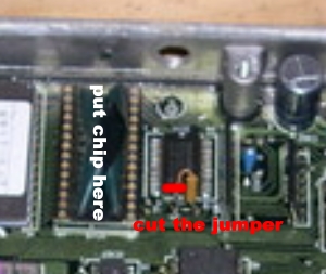

Old Subaru Turbo (till 1996) has spare 28pin socket for the extra-chip.
No re-flash. It can be re-mapped via external programmer.

The socket takes a Fujitsu 27C1028. These are quite hard to find these days :(

Hopefully I will be getting this spare ECU soon and desoldering the PROM and getting a good dump off it. We could definitely get a bin from the old select protocol 1 port but it is more reliable and easier at this point to simply socket a spare ecu for testing perposes.
Some people have successfully dissasembled dumps obtained through the select monitor port with a little success. So once I get the prom off and a socket on there we can see if we can move further.

It's socketed, and I don't think it would be too hard to pull the rom off. Pic of tag on case:
Pic as opened
And with daughterboard removed
The socket is covered with tape, so I assume it's not been played with. So what should I do with it? I don't even know how to power it up to check it out. I also don't have a burner or roms yet, but that will be on the way next week some time.

What Tap has is the older version's Liberty / Legacy Series 1 ECU, an 8bit ROM.

I just sell burned chips for old ecu, like G8, K2 and other that has spare socket from the factory.

-1992-1996 can be chipped
