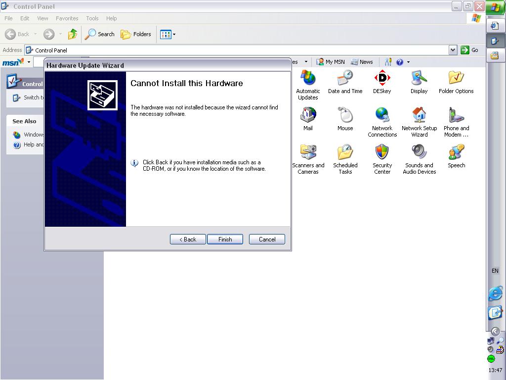

The cable arrived today. I connect it to my computer and it said a new device found. Ther was a choice to "Use Window Update to search for a Software", so I chose option "Yes this time only" ,then I clicked the "Next" button but failed with the expression "The hardware was not installed because the wizard can not find the necessary software" :(
Now I am in an absolute mess. Do I need to download a driver for it? Where can I get it?

Postby cboles » Tue May 02, 2006 12:39 am
The drivers are on the same page you ordered from:
http://www.tactrix.com/product_info.php?products_id=31
Specifically, for XP, you can use this one:
http://forums.openecu.org/openport%20drivers/win98ME2kXP/R9052154.zip
I'm in the process of reorganizing the site and making some howtos, sorry for the confusion.

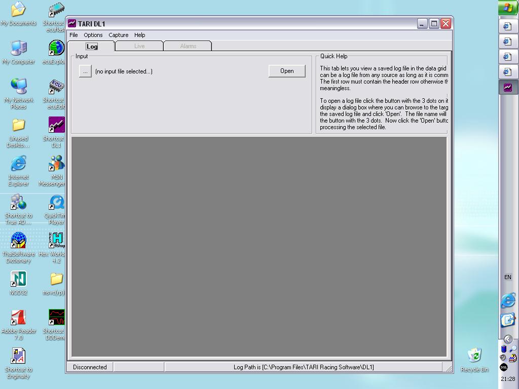

Have tried running every programs that I got: ECUFlash, Tari DL1, EcuExplorer only to find none worked! Through my inexperience eyes, I seems that the cable is not transferring data from the ecu to laptop. I'm not sure it's the hardware or software problem.. For example, when I ran Tari DL1, the "LIVE" tab is not activated meaning it didn't respond when I clicked on it. And the bottom left corner showed " Disconnected"

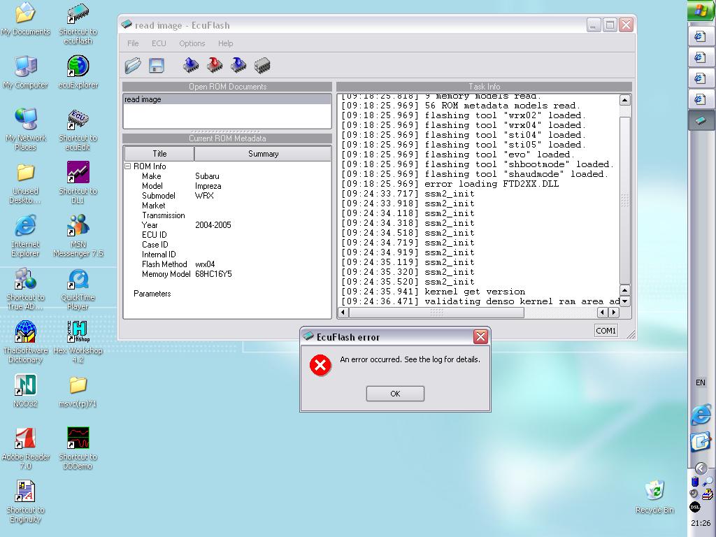

For Ecuflash, It poped up a window telling that my green connecter is not connected. If I proceed, it will show up the "error" window.

Postby Spec C Wannabe » Tue May 02, 2006 6:57 am
Error Window

Postby Spec C Wannabe » Tue May 02, 2006 6:59 am
DL1 screen shot

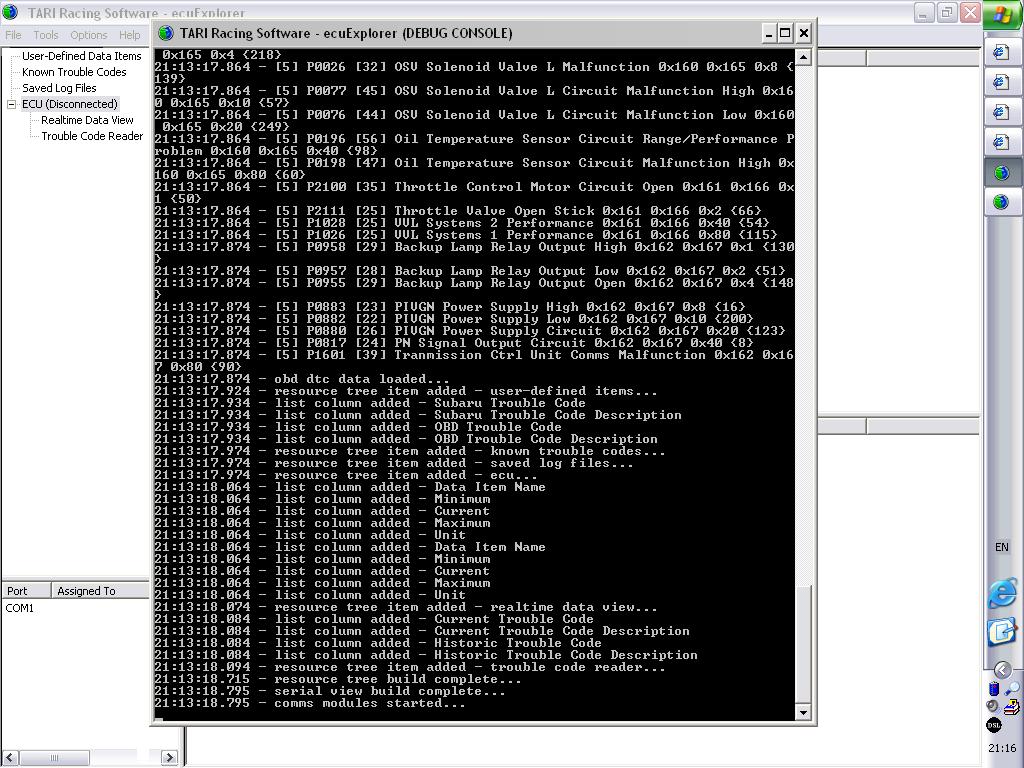

Postby Spec C Wannabe » Tue May 02, 2006 7:01 am
And this one from EcuExplorer....

Postby cboles » Tue May 02, 2006 8:18 am
At least in the case of EcuFlash, you need to go to Options | Port and select the correct port that the OpenPort is connected to. Right now you are connected to COM1, which is most likely your standard serial port.
Postby calvinc » Tue May 02, 2006 11:05 pm
you need to select a COM port for ecuExplorer to use. from the screen-shot the COM1 port has not been assigned to anything.
you must have the OpenPort cable plugged in first before the new COM port will be available for assignment. once its there then right-click on it and select the SSM option.
