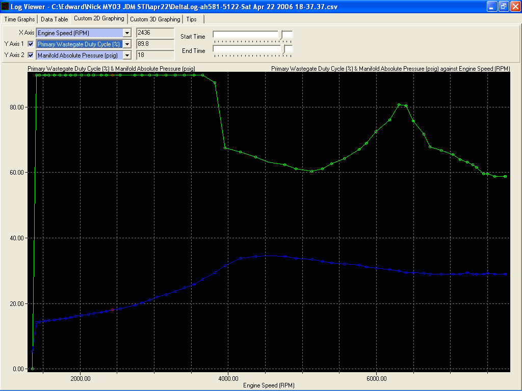

Postby west_minist » Sat Apr 22, 2006 7:11 pm
Hi Guys,
I think I found the problem.
I think the turbo is running @ max or there is too much back pressure.
But I have increase the wg and the percentages in the logging is the same as the stock map, but I must say that pressure logs are extended.
For instant, just into spooling, wg = 100%. The logs state 89%
I continue to find info stating that the turbo supports up to 400hp. We are not to far from that, but still a lot is left in this turbo.
Would the sti exhaust system hinder this?
From the post above, I guess we have reach our goal with the stock system, but looking @ that boost curve, we may be spool later, although 300rpm soon on your maps.
Please see below.
JDM STI WG.png (29.74 KiB) Viewed 5660 times
JDM STI Boost.png (29.43 KiB) Viewed 5682 times
Postby west_minist » Tue Apr 25, 2006 8:08 pm
Analysing the logs some more, going on the abs graph, I can see the wg need tuning to get the boost we want. I can see that effects before 4800rpm.
