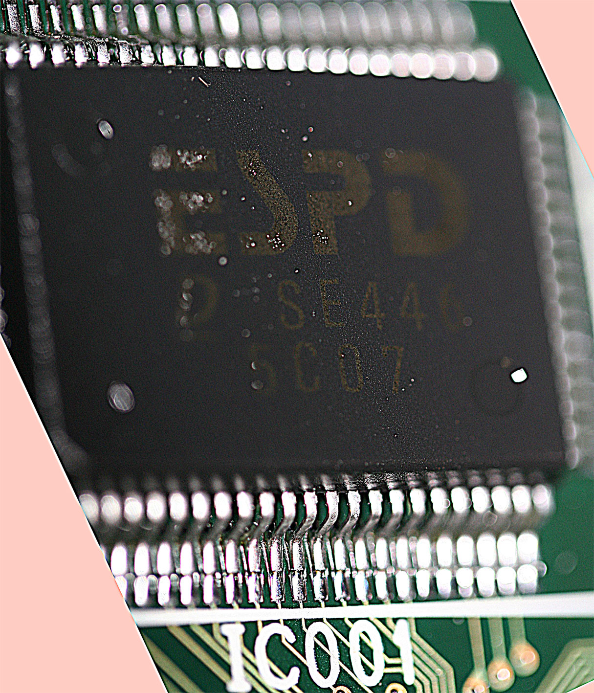

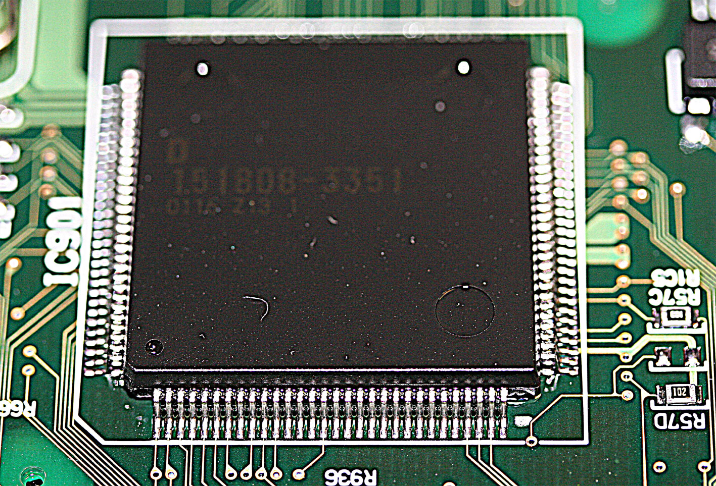

I have a Land Cruiser hdj100 mdl.2001, it has a Denso ecu. Toyota dealer can reprogram the ecu through dlc3-connection, but then i am stuck with org. software. As far as i know Toyota are using modb protocol and the only obd-kit i can get for this is the EFI-Scan, but i don't know if i can reprogram engine-ecu with it. Anyone knows?

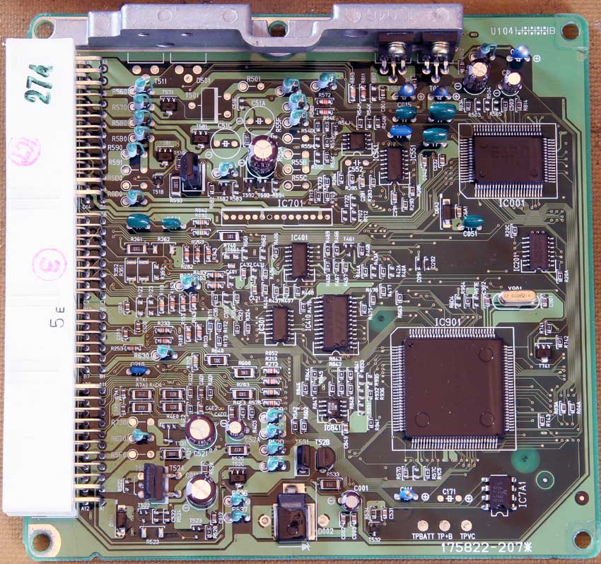

Here are some pictures of the Denso ecu. It's almost identical to Subaru ecu's i have seen other places in this forum.
I have searched after the chips but with no luck.
If anybody can help identifying the chips on this ecu, it will be much appreiciated.
Big chip no: 1.51808-3351
Smaller chip: SE446 - Second line: 5C07

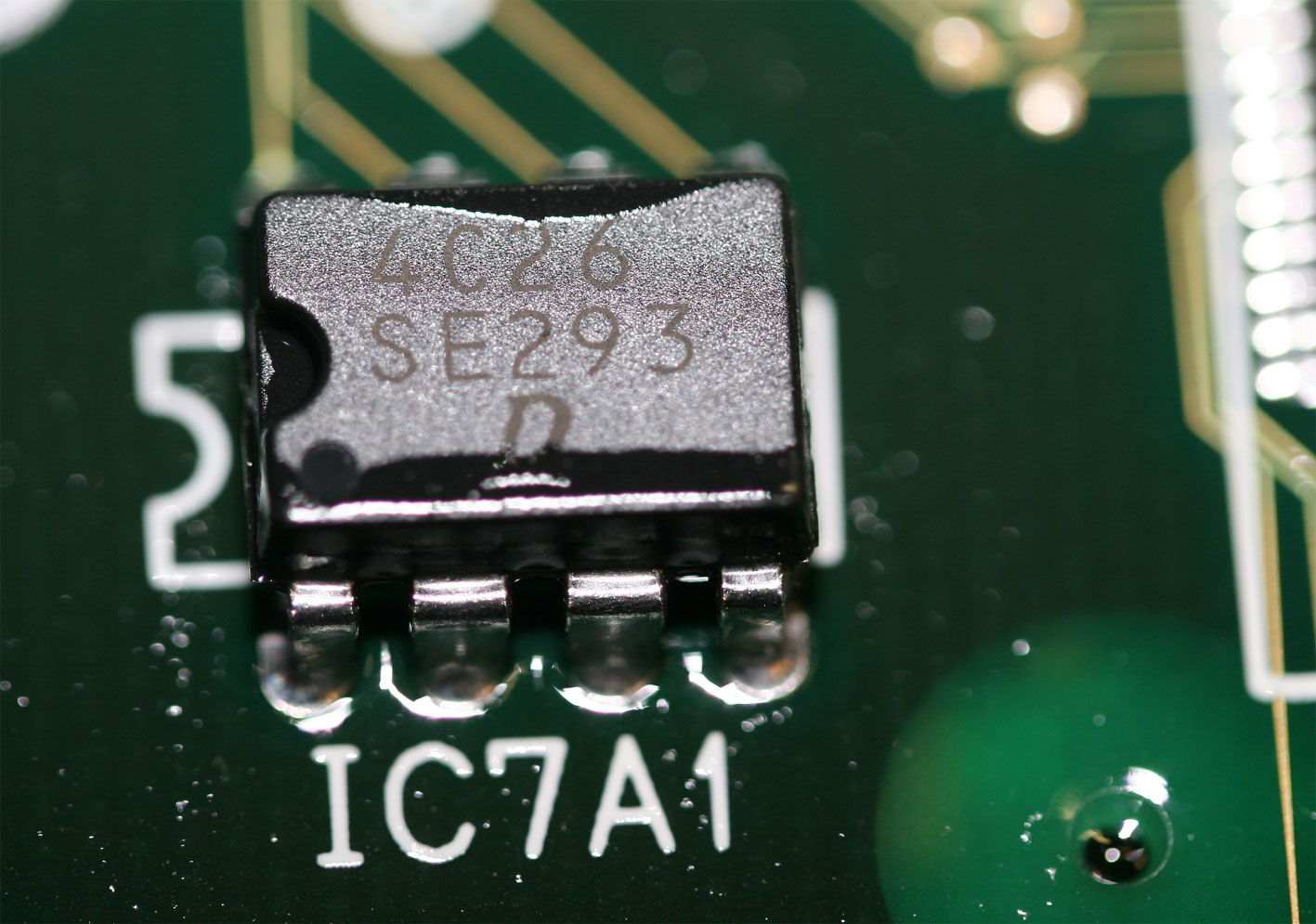

Little "old" 8pin DIL: 4C26 - Second line: SE293
Chip side
The smaller chip

Postby shoel » Sat Oct 04, 2008 1:12 am
Picture of the little "old" one.
Little "old" one.

I know nothing about these, but I do know that just because the ECU is made by the same company as the Subarus, this does not mean the reflashing methodology is identical or even similar. In fact I will almost guarantee that they have their own way of doing things.
The exception will be ECUs that support J2534 pass-through programming. Even then, each manufacturer has their own security algorithm for 'getting in' to read and reflash.

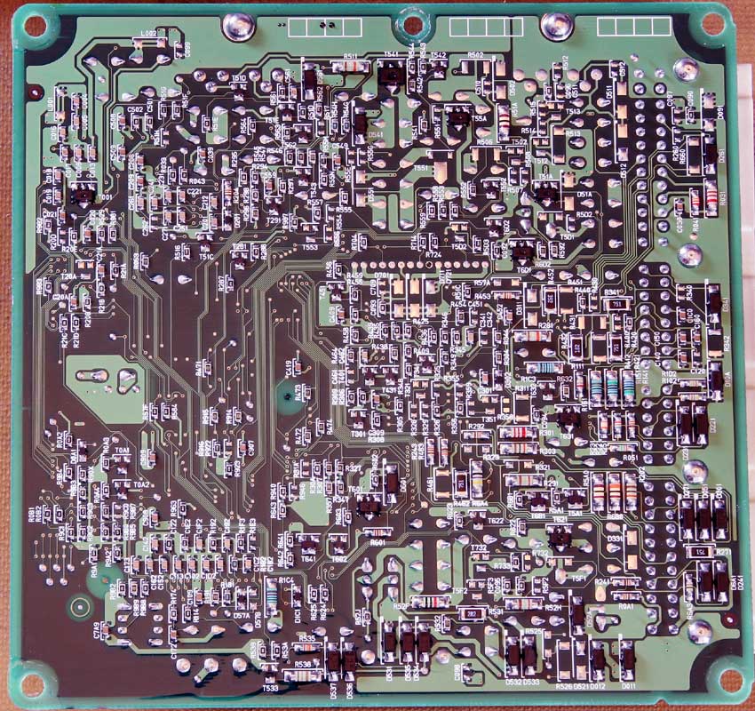

Do you have pictures of the reverse side of the ECU?
intrawrx
Postby shoel » Mon Oct 06, 2008 2:41 am
Radsdau: I'm afraid your informations are correct, but i think there must be a workaround to "lift-off" the software. Of course the passthru programming would be the pleasant way.
Intrawrx: Yepp, here it is.

That's too expencive(about $6000), but if i can get help identifying the cpu. then maybe i can use my Xeltec programmer or EFI-scan.

I wonder if its a HC16 variant, maybe trace a few of the legs of the MCU to see if they have provided nice neat solder pads.
