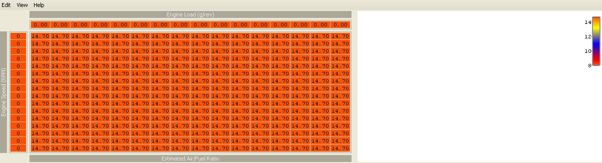

Postby S54fan » Wed May 07, 2008 3:31 am
When you edit table metadata you put the addresses in hex.
Post a pic of the fuel map you display and the "edit table metadata" window?
Postby Frenzy » Wed May 07, 2008 7:52 am
That ?
And i create " GT16BITBASE " To be according with the conversion , etc ;)

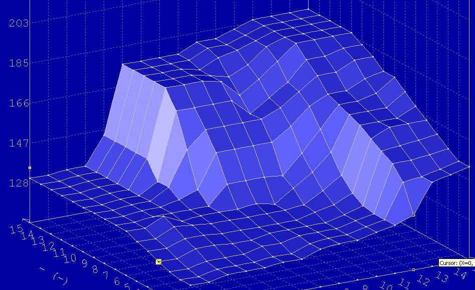

Postby Frenzy » Sun May 18, 2008 5:56 am
I hope to tune/flash GT wih ecuflash mate...
The map actualy :? :

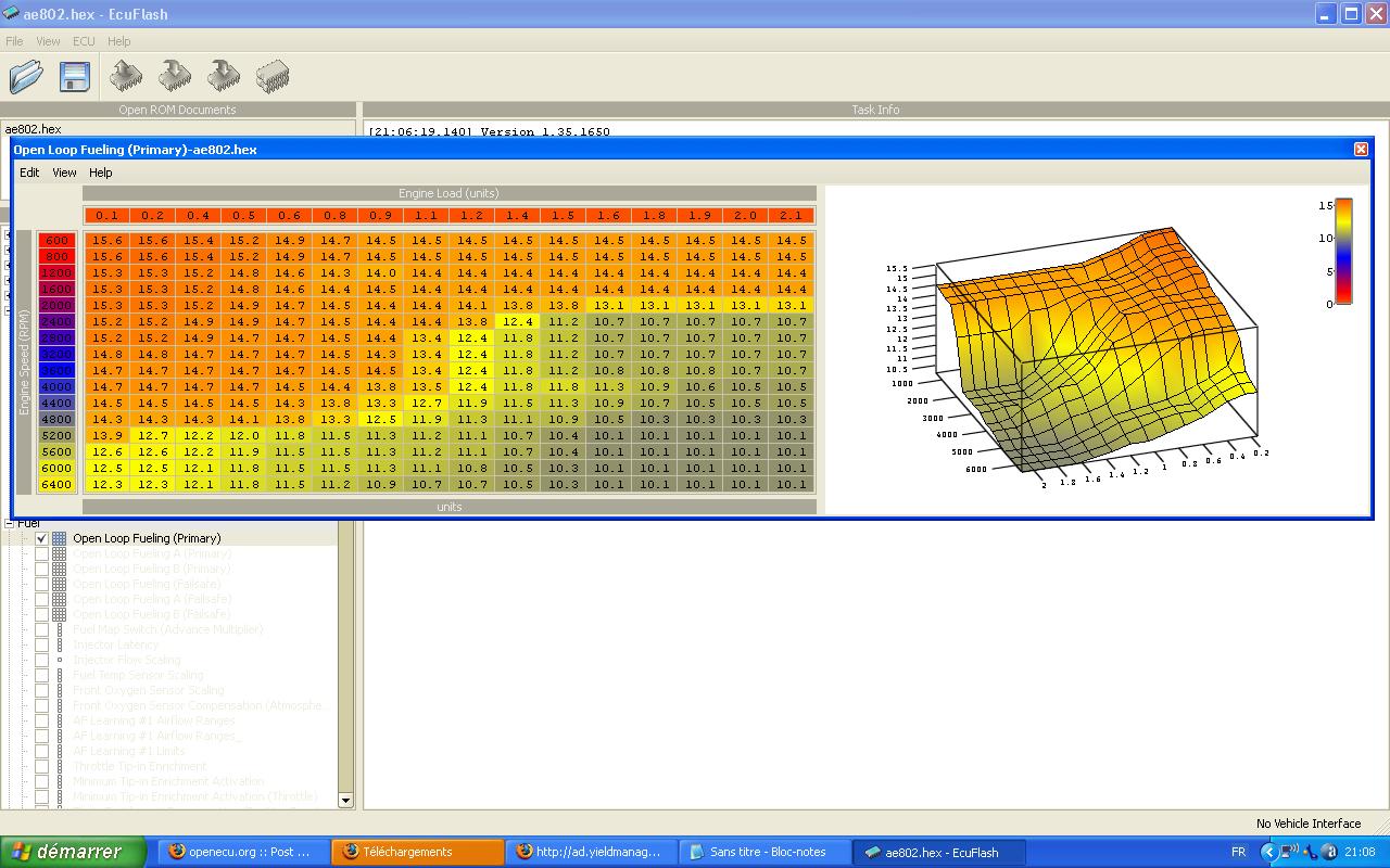

Postby Frenzy » Sat May 31, 2008 11:12 am
Hi.
The french community have found the problem ! :wink:
In fast you need to add 10000 to the ofset.
So when you want to put 138F , you need to whrite 1138F.
Why ? Don't no... Can freon explain ? :lol:
Timming advance are ok.
Maf is in progress.
Duty and boost too , they're ok , but throttle isn't ?
Maye be need add over 10000 ? Or less ? Don't no...
