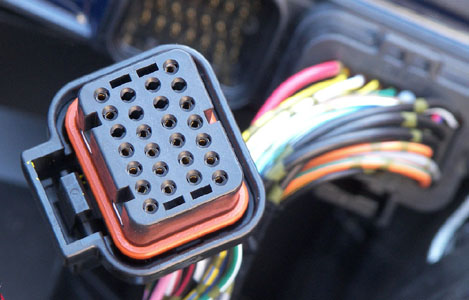

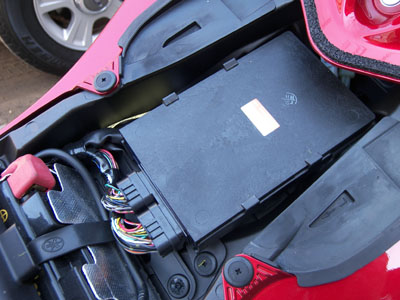

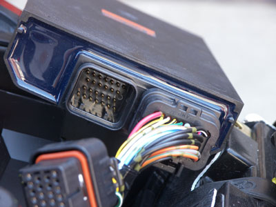

I read in some review that its a Mitsubishi ECU but its is clearly labeled as a Denso unit. Here are a few pictures. It is obviously well potted and not easily disassembled. I'll follow up this posting with more images.
One last thing. I have downloaded the firmware for the latest setting for the race ECU. Can that provide any clues?
(BTW: You won't see the images unless you are registered, sorry.)
2007 ECU Connection 001-2.jpg (57.04 KiB) Viewed 21196 times
2007 ECU Connection 005-2.jpg (56.23 KiB) Viewed 21185 times
2007 ECU Connection 004-2.jpg (51.21 KiB) Viewed 21182 times

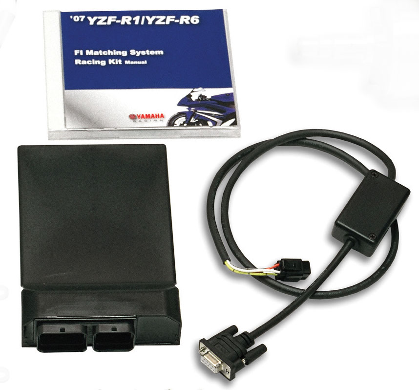

Okay, here's what the Race ECU looks like as well as the cable adapter.
2007 Yamaha R1 Race Kit ECU.jpg (113.83 KiB) Viewed 21193 times
ECU Connectors On-Line.pdf
This shows which pins missing in the stock harness would map to the communications port used to tune the race ECU
(59.17 KiB) Downloaded 1040 times

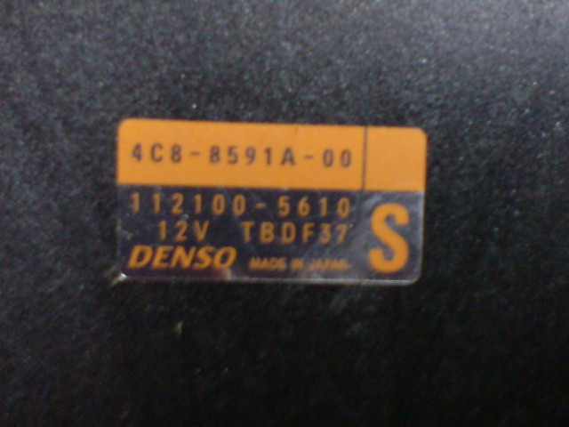

Here's some research into the ECU Labels for different markets:
1) They are all Denso ECUs
2) The part numbers are:
Australian ECU is 4C8-8591A-00
Canadian ECU is 4C8-8591A-30
US ECU is 4C8-8591A-20-00
So I'd say the Australian/European ECU was developed first then the US followed by the Canadian. The engineers probably tweaked the European code to get the US code and then tweaked it again for the Canadian. If so, the error was introduce in the first tweak and went along for the ride in the second tweak. I'm guessing but it seems logical.
The European and Canadian R1's have chipped keys and security
That will throw a money wrench in the works because it will prevent us from just downloading the European firmware and flashing the US version. We'll have to hack the code at least a little bit before we flash 'em.
Australian ECU Label
Australian ECU Label.JPG (68.35 KiB) Viewed 21116 times
