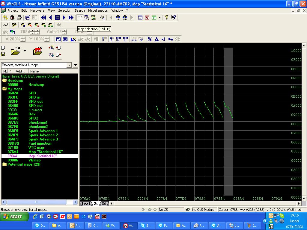

See the maps in grafic mode of the ETC
Postby christian_piasini » Tue Apr 15, 2008 8:51 am
This is the grafic view of the ETC map on one other car with the Denso ECU.
If some one want more stock dump to see.
Just ask ... ;-)
Regards
