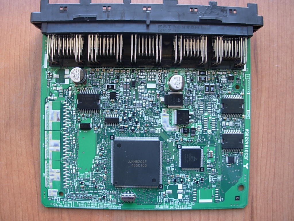

Is there solution for reflashing that car?
May be can somebody help with info about processor.
I've seen http://forums.openecu.org/viewtopic.php?t=759&start=0
may be (or may be not) about this subject and I want to know:
1.) Is this MH8202F?
2.) Is there the tool for fleshing this proc.
3.) With what processor MH8202F is compatible (MH8206, MH8305F, 7202)?

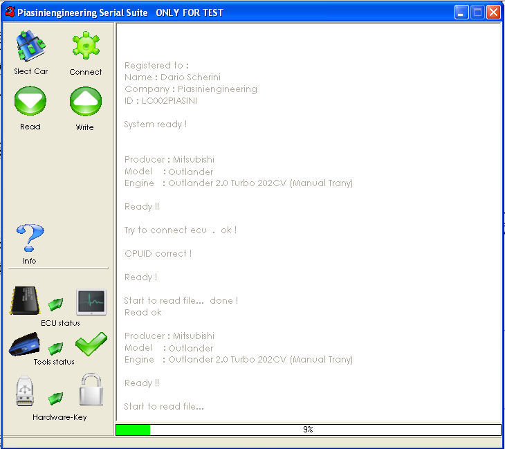

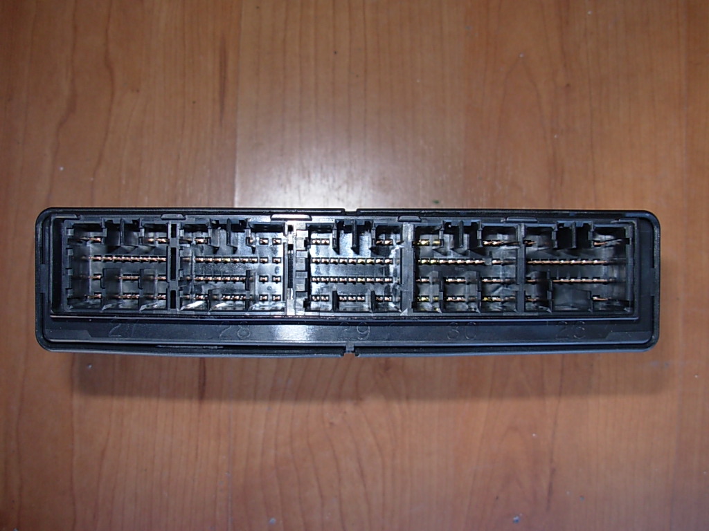

Hi morfeus
Postby christian_piasini » Sat Feb 02, 2008 7:48 am
Here some details you ask.
MCU is MH8202
Some pictures of the ecu too.
Bye
outlander 20T_reading.jpg (72.99 KiB) Viewed 3790 times
