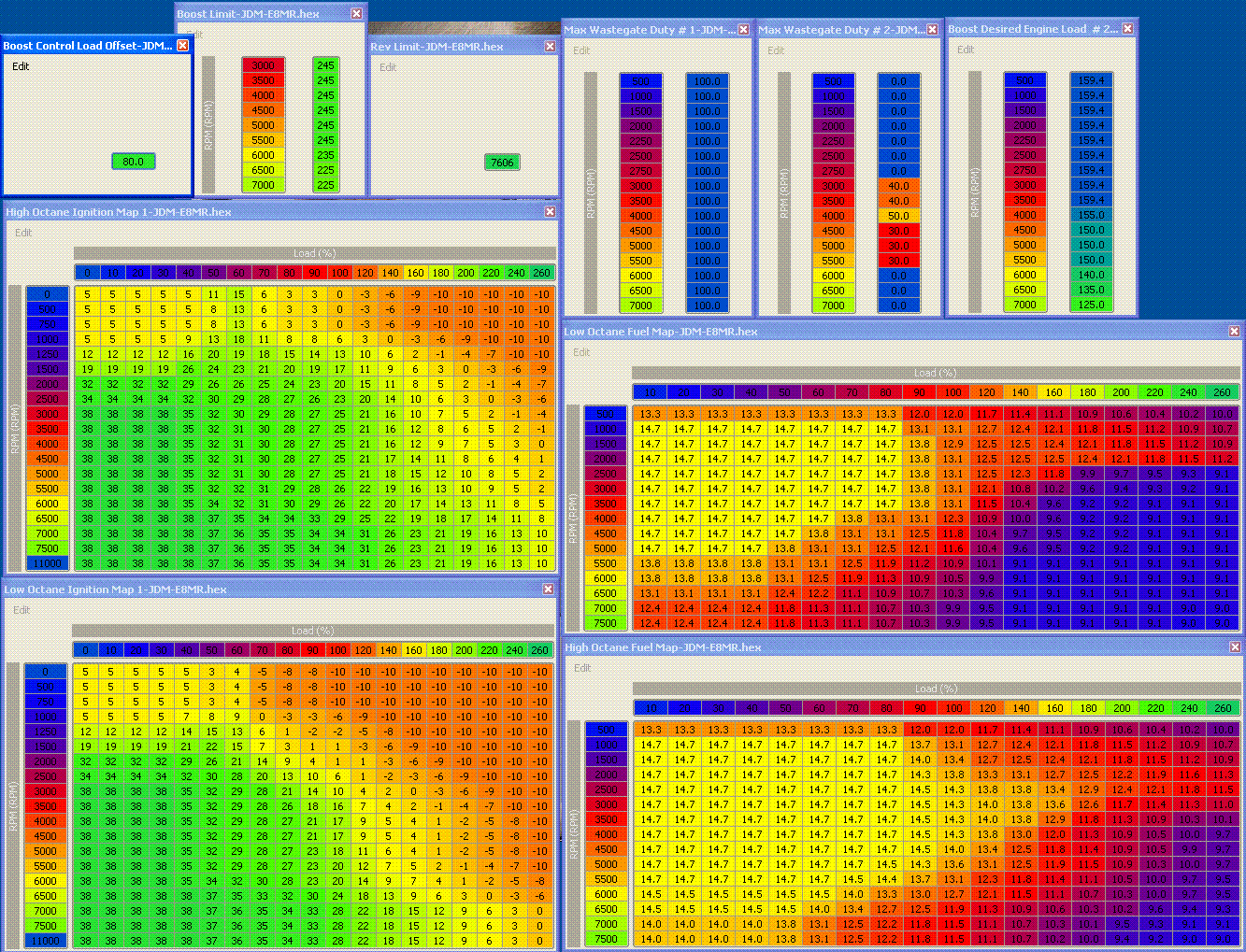

Put the xmls in program files/ecuflash/rommetadata/mitsubishi/evo/
On is for FQ300/8 non-MR, and the other is 8MR which inherits it.
I intentionally mislabelled the wastegate duty maps as there as 7 of them - 4 are at 100%, I show 1 of these only as #1, and the others as
2,3,4. 2,3,4 are the ones to change to raise boost.
WG tables:
4116, 412c, 4142, 4158, 416e, 4184, 419a
(2 solenoids, the 100% ones are for one solenoids, the non-100% ones for the other, set the non-100% ones the same when altering).

It seems that people have trouble getting ECUflash to work with xml files. Without a detailed how-to on the subject, it is difficult to identify what problems people are having. Also, saving an xml from one machine and transferring its function to another seems to depend on what xmls are on the other machine and if the base files have been changed.
It is however relatively straightforward to load up the ROM without the xml files and get it to inherit Evo9 base, define a dummy map of location 0 with axes 0 and 0 and then save models. Then manually edit the xml file to match the main details of what I posted.
