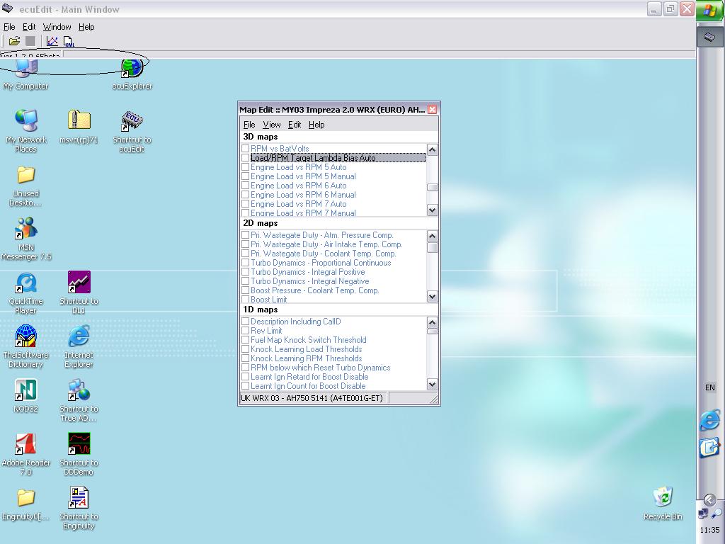

Postby Spec C Wannabe » Thu Apr 27, 2006 9:45 pm
Got it opened! What a relief! Thank You Very Much :D
Some more questions:
1. I wonder if I can open images from different ECU versions at the same time? Do I just copy corresponding XML file of each ECU version into that XMLDEFS directory?
2. Are there any User Guide for this program somewhere?
3. I can not resize my Ecuedit main window by dragging the lower edges down (see attached file) Is this normal?
Your help is highly appreciated
Nik
Ecued Screen Shot.JPG (88.92 KiB) Viewed 14652 times
Spec C Wannabe
Posts: 59
Postby New2Scoobs » Fri Apr 28, 2006 3:27 am
Yes you can have multiple ECU images open. You first need to have a valid XML file for each image you want to open and of course the relevant 192k ROM hex file.
Use the XMLWRITE v4 program (download from link below).
It will ask for the CALID (e.g CALID for your own ROM would be 4TE001G)
** Use UPPERCASE characters when you type in the CALID **
I think you can press enter for a list of valid CALIDs
Select "3" for the output type (ECUEDIT single offset). You will now have a new XML file in the folder you launched XMLWRITE from. Copy this XML file to your ECUEDIT\XMLDEFS folder.
http://forums.openecu.org/viewtopic.php?t=441
