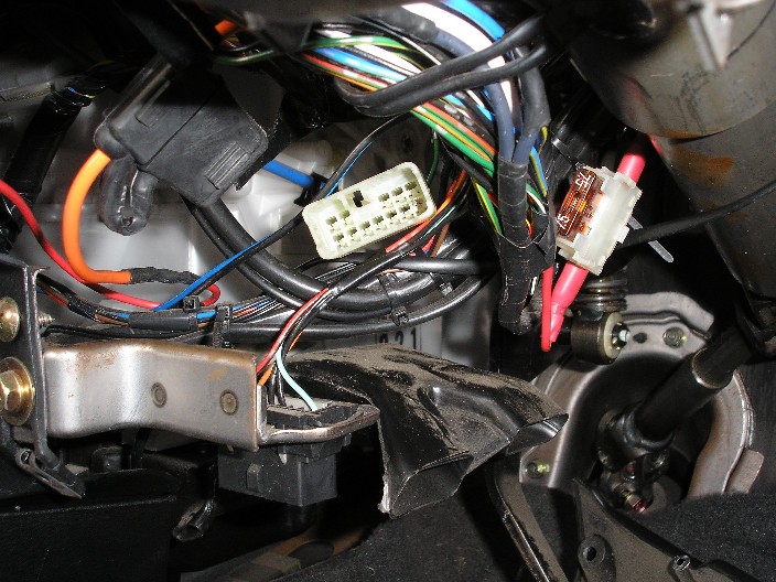

Ok I know that EcuFlash wont be able to reflash an older Evo 4,5,6
but I thought that the hold up was the fact that there was no way to tell the ECU to enter programming mode as the misconception was that there was no white flashing connector on the earlier models,
but I have been investigating this and yes the EVO 4 has only the black standard OBDII connector but my EVO 5 and I know for a fact that the EVO 6 have the white reflashing connectors pics attached,
and the tatrix cable fits in and is connected to the pin inside the connector,
I dont know if people know this but it is there.
Can I please have a version that flashes this ECU please

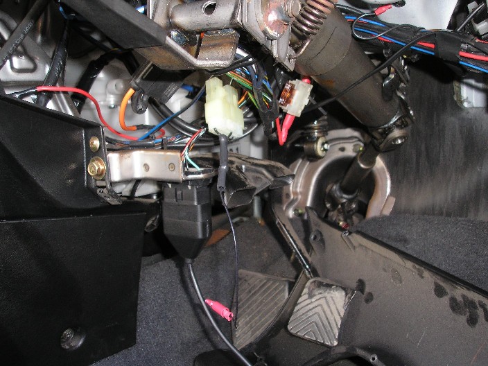

another pic

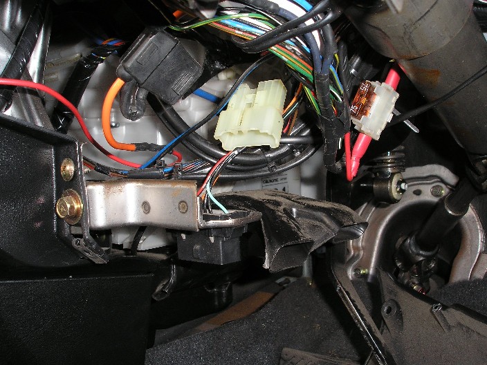

another

Evo4 has the OBD2 connector?! Interesting.
Mitsubishi Have been using the white connector in their cars since the '80s, for diagnostic fault code extraction and viewing of live engine data. The all used to have just this plug (without the OBD2 plug - seeing as OBD2 wasnt around then).
We have gotten JDM imports here for years, and every old EFI Mitsubishi has one. It is simply the plug mitsubishi used before OBD2.
I cannot recall whether and Evo4 would have a white plug, but I would think it more likely to have just the white connector than the OBD2 one. I am keen to see a picture, always keen to know more :)

no I dont think the Evo4 has the second white connector,
I was with a guy over here some time ago while he was flashing/tuning an Evo 4 with Ecutek, but the only way he could do it was to remove the ECU from the Evo 4 and install it into an Evo 5 which was also there that day he said that the Evo 4 did not have the second white connector and thats why he had to put the ecu into the 5 to flash it

the evo5 manual wiring diagram doesn't show that white diagnostic connector.

Any of the 5 or 6 Evo's Ive seen all have em thats how they flash/tune the standard ECU with the Ecutek software,
the only one that dont have it is the 4 as I said you have to remove the 4 ECU and flash it in a 5 or 6,
