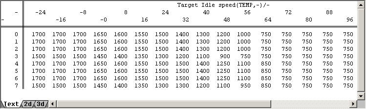

Postby cdvma » Tue Oct 18, 2005 1:42 pm
Does anyone have the offset for idle?
cdvma
Posts: 86
Joined: Tue Jan 04, 2005 9:18 pm
Location: Roch. Inst. of Tech.
Postby Spiider » Tue Oct 18, 2005 4:44 pm
The fuel and ignition settings for idle are there as above.
They show settings for 600 rpm, but that seems low to me.
Time to do some more research...
Postby cdvma » Tue Oct 18, 2005 7:48 pm
Which ones actually contain the idle RPM target? I see fuel settings, timing settings and timing correction settings. The rev limit is set as a simple number...is there nothing like that for idle? I don't seem to see where the actual RPM would be set.
cdvma
Posts: 86
Postby fastchip » Wed Oct 19, 2005 12:35 am
Chris
Have a look at address 0x2A774. I think the Idle target values are there.
Idle speed is dependant of coolant temperature.
I don't know which one of the 8 tables the ECU chooses from. Maybe only the first entry is active and the other ones are reserved for future use.
I am also not sure about the temperature settings but they should be close.
Maybe Spiider can comment on that.
fastchip
Posts: 15
Joined: Mon May 30, 2005 9:02 am
Postby cdvma » Wed Oct 19, 2005 2:23 am
Yes that is what I'm looking for. Very nice, thanks! I remember with the DD live user tuning you can set A/C on/off idle targets as a single number so I'm thinking there is also an offset number for A/C (and possibly for normal as well) stored externally to the map.
That workbook you have there...is it public? Sure looks nice :)
