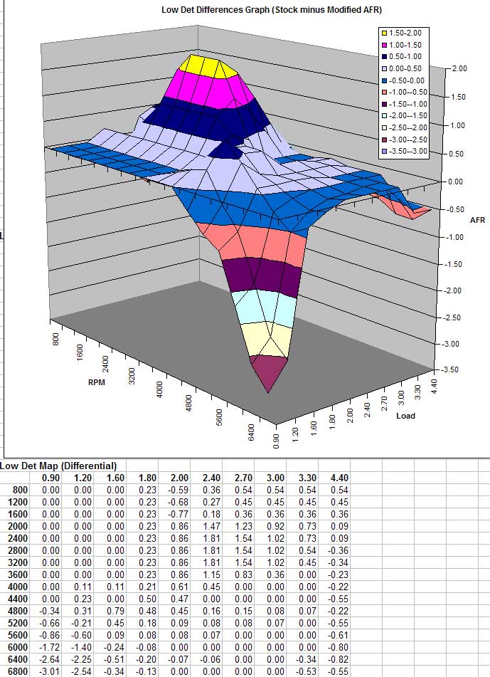

Not sure if anyone else has suggested this yet but .... it would be really useful if you could provide an 'export to csv' format for the maps that you've described. This could work in one or more of the following ways:
1. Export to CSV of all maps that you've described (perhaps create separate files with the name of the map). This would be a top-level menu option.
2. From the map view window where you see the table and graph, you might want to export that map to CSV. Menu option from within the map view window.
3. Lastly, when you select one or more elements from the table in the map view window, this highlights the associated graph. It would be good if you could copy the current selection to the clipboard in a CSV formatted way so that this could be pasted dirrectly onto MS Excel or OpenOffice. The copy would also copy the associated table axis info as well, in addition to the data items selected.
All the above would support those people doing custom graph analysis.
In fact going further again, I'm only doing this so I can get a 'map differences graph'. For example this would provide a 3D graph of the differences between a stock and modified Low Det Fuel map. Given that maps can be based on different axis scales, this difference graph would have to perform any interpolation of values as required.
I'm sure this would be a useful map analysis feature. Anyone else agree?
Anyway, keep up the great work,
Postby cboles » Sun Mar 05, 2006 1:01 pm
I've been thinking of adding ratiometric differencing down the road, but I hadn't really thought about the axis scaling problem. It goes beyond interpolation since the end values of the two maps may be different. I guess one could extrapolate as well to produce values beyond the ends of a given map for the purposes of comparison, but it only make sense to extrapolate in the same way the ECU actually does, which may be map dependent.
Postby crispyduck » Sun Mar 05, 2006 1:16 pm
Colby,
The ratiometric differencing would be really useful. Regarding the 'ends of the map' issue. I'm simply comparing the max load values that are common between the two maps under comparison. As you've said you'll need something more complicated when you get to the ends of the map.
If your interested I've attached an extract from a spreadsheet I'm trying to do to graphically visualise the differences between my stock and PPP maps. I've only done the Low Det Map so far, but its highlighted that at high revs and low load the 'modified' map takes just over three points of the AFR when compared to 'standard' map. It also shows, that as you might expect, it adds more fuel between 2000-3600 RPM when under higher load.
It's only when you (well me anyway) see things this way then you can spot potential issues.
Graph showing differences in AFR between a stock EURO MY03 WRX Low Det Map and a 'modified' map.
