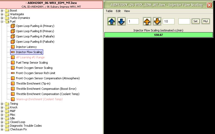

Postby ravenhil » Sun Jul 01, 2007 3:20 am
merchgod wrote:
ravenhil wrote:That has been done with limited success. However, injector scalings, among other features, are not present in Enginuity.
Umm, what? Injector scaling is most certainly supported in Enginuity.
no sir! I was able to download a .hex file from my buddy's EDM 06 WRX in ecuflash but i get really wierd tables with x values that is not in ascending order. I get plenty of invalid tables too. Injector scaling is rated at 75000+ cc/min. :!:
The closest def i can find was USDM 06 WRX so i "inherited" its values (sorry, my cc speak is appalling, I know) and got the above. When I used Enginuity, there are limited values.
Check this out...
look! no injector scaling!
ravenhil
Posts: 46
Joined: Fri May 04, 2007 8:09 pm
Re: A8DH200Y 2006 EDM WRX definition
Postby Jon [in CT] » Sun Jul 01, 2007 6:38 am
ravenhil wrote:When I used Enginuity, there are limited values.
You must set your Enginuity User Level to at least 3 in order to modify injector scale values.
View->User Level
Postby merchgod » Sun Jul 01, 2007 8:10 am
What Jon said. Plus you should download the latest ecu defintions (which are newer than those included with the Enginuity download):
http://www.enginuity.org/about360.html
Plus nearly all your questions and problems are answered in the Enginuity FAQ:
http://www.enginuity.org/Documentation/EnginuityFAQ
merchgod
Posts: 243
Postby ravenhil » Mon Jul 02, 2007 12:29 am
doh!!! it works! what a relief! thanks, you guys rock!
