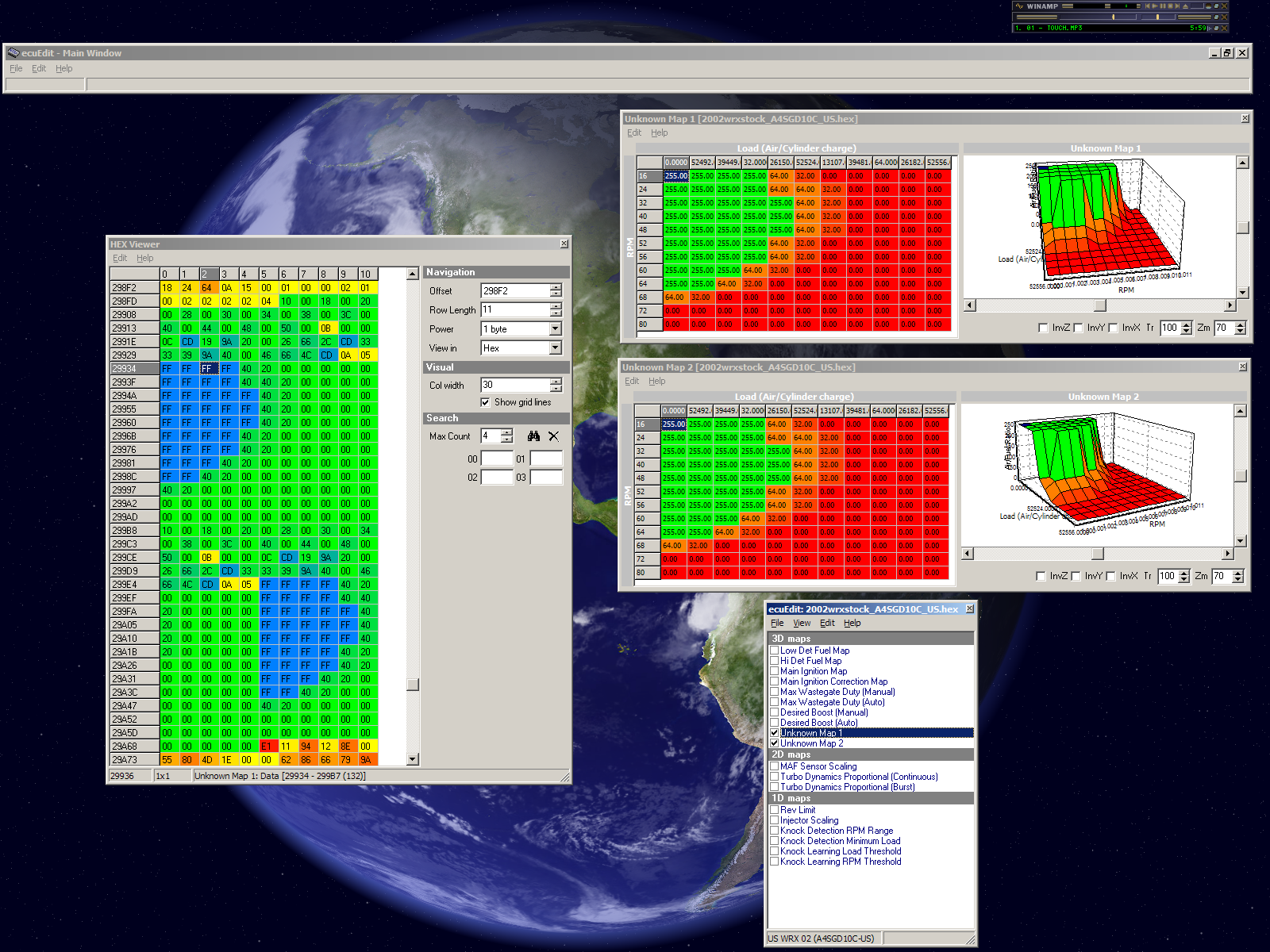

Postby Kha0S » Fri Jan 27, 2006 2:52 pm
I found these two 3D maps embedded in the A4SGD10C ROM... any ideas what they are?

C'mon guys... someone out there has to have some clue of what these are...

Postby Freon » Mon Jan 30, 2006 1:30 pm
I've found one (or more) of these maps in most of the ROMs I've looked at. I have no idea what it is for. It looks like more of a mask than a real map.
Postby silverpike » Thu Feb 02, 2006 11:50 pm
Perhaps it's knock detection? I know that in most cases, the knock sensor isn't used at high load and high RPM. It almost looks like this in the table.
The best way to discover what a table's used for is to find out where in the code it's referenced (dissassembly) and then find out if there's an IO port being accessed nearby in the code. Once the IO ports have been mapped, you can tell what output is being controlled by that code, and from there the table gets much easier to figure out.

Postby MRF582 » Fri Feb 03, 2006 5:31 am
silverpike wrote:Perhaps it's knock detection? I know that in most
this can't be the knock detection map b/c the reason the stock sensor
doesn't read above 5000 or 6200rpms depending on what you believe is
because it runs out of space. To save 'bytes' this system of hexadecimal
is used in the ECU which is makes it so confusing.
There are two other maps in the ECU which control Knock detection and
learning. Knock Learning is only done up to 5000rpms only. But Knock
Detection is done over a range upto 6200rpms or so. You'll see your
'Ignition Correction' or "Dynamic Advance' still work. Meaning it'll
decrease when the ECU pulls timing for knock.

Postby Spiider » Fri Feb 03, 2006 8:08 pm
MRF582 wrote:To save 'bytes' this system of hexadecimal
No offense intended but what do you think microcontrollers are programmed with?
Hex / assembly langage mnemonics are the only tools that I and many others program them with.
I don't know what those mystery maps are yet, I have been meaning to sit down with IDA and the datasheet and take a look.
