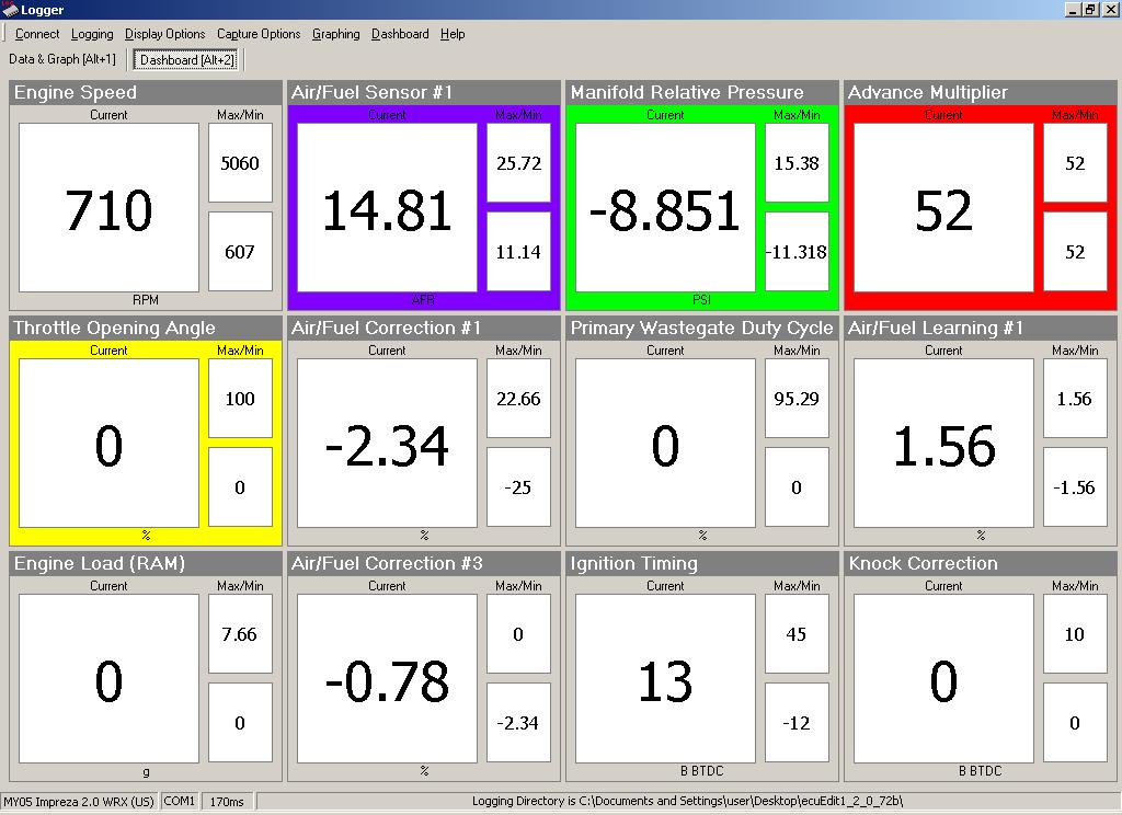

Postby ev8siv3 » Fri Jul 14, 2006 9:00 am
IAM on 2005 USDM WRX = 52??
ev8siv3

Postby epifan » Fri Jul 14, 2006 10:01 pm
ev8siv3 wrote:IAM on 2005 USDM WRX = 52??
ecuEdit don't automaticly find IAM or Engine Load. You must select your own correct address in parameter alternative dropdown menu.

Postby ev8siv3 » Sat Jul 15, 2006 8:23 am
I realized that and selected mine of 20168 and it still comes up with 52.
