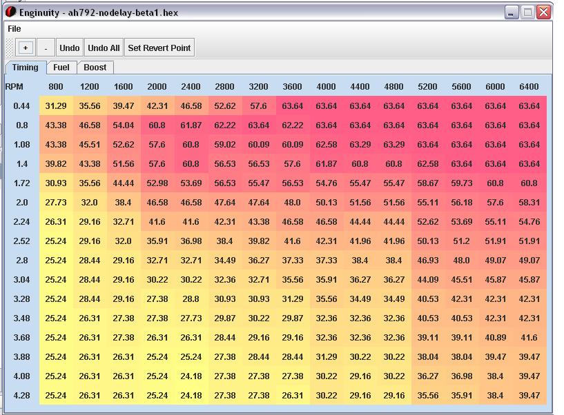

Alright, things are coming along pretty well. Just a couple more questions for now. I've got the boost table loaded and I can't figure out the calculations for boost or throttle. Any clues?
Here's what I've got done so far. You can open a file (path is hard coded as I haven't gotten to that yet), it loads fuel, timing and boost tables and displays them, and you can modify the data. I haven't gotten to writing to file yet.
Edit: I also can't figure out the EGT formula. I'd really like to get rid of that stupid CEL.. :)

Postby cdvma » Tue Nov 08, 2005 1:57 pm
Lookin good! Two observations.
1) Usually the load goes horizontally and the RPM increases as you go down vertically. No biggie, mostly personal preference and how I've seen it.
2) Why does everyone and their brother use Java? Heheh not looking down on it (I still use it for some stuff) but I just realized every project on here thats been posted recently is Java :)
I also haven't got time to figure out why your code was doing the negative thing...I've been busy on other work.

Postby ahains » Tue Nov 08, 2005 2:19 pm
cdvma wrote:Lookin good! Two observations.

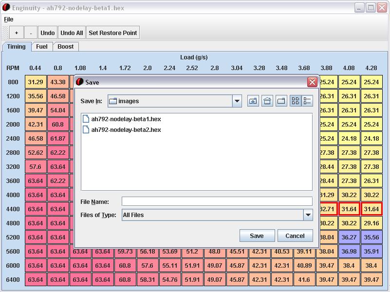

Postby qoncept » Tue Nov 08, 2005 2:20 pm
cdvma,
1) I haven't looked at any of the Subaru software, but everything else I've seen has had the RPMs on the x axis. Mike said the same thing, so I went ahead and changed it. No big deal either way. :) It would've been a lot less confusing doing it that way to begin with, I think, since that's how it's done in the image.
2) I personally use Java because it's what I know best. It's great for RAD (though it's quickly getting hard to organize). It's been a while since I've used it, though, so for the first week or so I spent more time getting back in to it and working pretty slowly.
I finally buckeled down and posted on Sun's Java forums. Someone told me to add "0xff" after bytes and that took care of the negative problem. I'm concerned now that when I try to write back to file it may cause some confusion but I'm keeping my fingers crossed.
For those interested, I've been working today more on usability and less on actual functionality. All the buttons now work. Next up actually writing files, then a dialog to open files. At some point I also need to add mouse dragging to select multiple fields. Eventually my goal is to be able to open a log file with AFR, load and RPM and automatically tune the fuel table. I've been working on it quite a bit and I imagine I'll probably start to slow down before too long, and then I'll probably keep the source on enginuity.org for other people to help with. I hope to have something pretty usable maybe in a week or two.
Postby qoncept » Wed Nov 09, 2005 7:25 pm
Just another little update. Pretty much everything present now is functional. You can open, close, save and so forth. I've got problems when you already have an image open and want to open another (it doesn't open multiple windows, what I want it to do is close the one currently open and replace it with another). No big deal, but I'm about ready for bed and I think I've made enough progress for today. Things are going pretty well and I think I may be able to release an alpha version this weekend if anyone wants to test it.
At what point should I start posting in the Users Tuning Software forum?
Just as a note, this is set up right now only for the offsets in the 2004 WRX forum. I'm guessing most ECU versions are the same for these few tables but I haven't looked as I haven't been concerned with that yet. I plan on using XML, or maybe just an INI or serialized object to store offsets for different ECU versions -- is the ECU version stored in the image at all? That would help a lot. Thanks!
