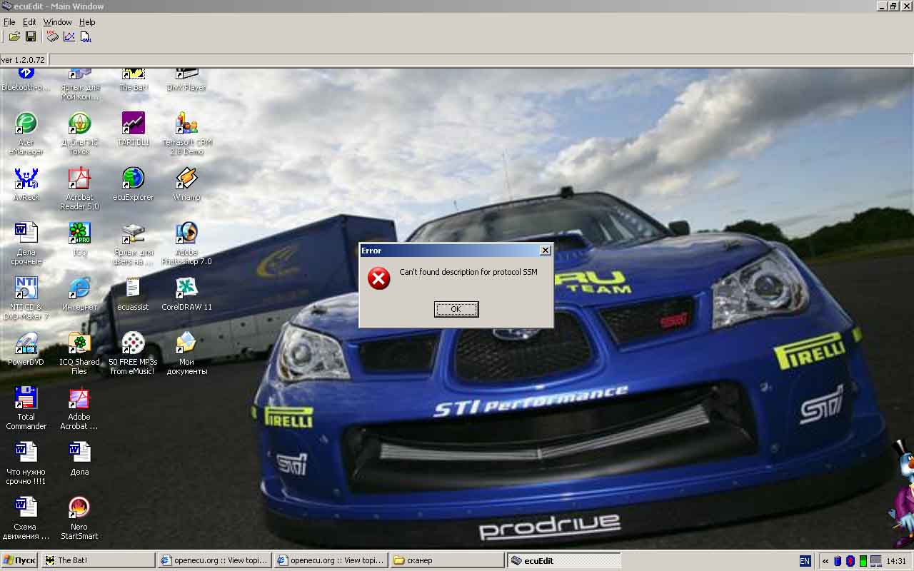

problem with use ecudit
Postby mayday72 » Thu Jul 13, 2006 11:32 pm
When I start Ecuedit, he does not work, and I see such message
That I do incorrectly.
Subaru B4 twinturbo Japan MY01
Openport 1.2

Postby JRSCCivic98 » Fri Jul 14, 2006 6:24 am
Extract everything (not just one file) out of the zip and put it in a directory. That will fix all of everyone's problems. How hard is it to do this people?
