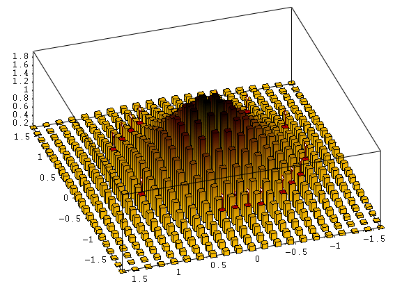

qoncept wrote:I was thinking about the 3D rendering of maps like epifan showed above. I've never even looked at them and was curious if anyone thought they were useful enough for me to include. Anyone?
I working on adding 3D mapping to EcuFlash too, but mostly because there is a good OpenSource 3D plotting package for Qt that I can use, so it really isn't very much extra work. I'm wondering if a 3D bargraph plot like this might be more useful than the surface plot style:
Postby Freon » Tue Nov 29, 2005 9:14 am
I'm a fan of surface, although 3d bar is ok. I use surface when I edit my own UTEC maps in Excel.
Postby crazymikie » Tue Nov 29, 2005 1:06 pm
I kind of like the bars :)
Is there a way to change the coloring based on the height of the bars? That would be nice.

Postby cboles » Tue Nov 29, 2005 1:13 pm
crazymikie wrote:I kind of like the bars :)
Mike
Sure, the ones i've shown are colored, it's just a subtle scheme. You can also flag the tops in various ways (shown) to overlay some other data (e.g. a parameter from a log).
Postby qoncept » Tue Nov 29, 2005 2:16 pm
What do you use it for? I guess I never understood what good they are.
Postby cboles » Tue Nov 29, 2005 2:22 pm
I agree with you Jared - they aren't very useful in any quantitative way. It's easy to spot outliers in the data with one though.
Postby qoncept » Tue Nov 29, 2005 3:30 pm
cboles wrote:I agree with you Jared - they aren't very useful in any quantitative way. It's easy to spot outliers in the data with one though.
That's what I figured.. but if someone can point out a reason they're useful (outliers could be spotted by color in the tables) I'll go ahead and bump it up on the priority list. I don't have a whole lot of actual tuning experience and could easily be missing something though.
