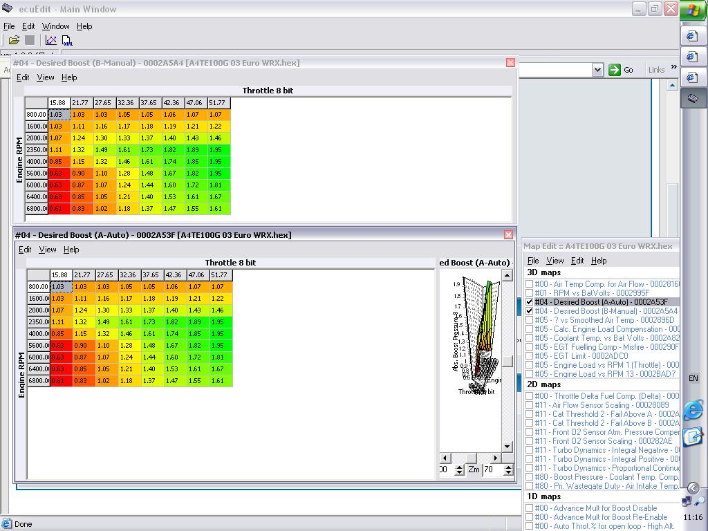

Found a bug: Cant re-enable 3-D Graphic Display
Postby Spec C Wannabe » Wed Jun 28, 2006 8:31 pm
Hi Epifan,
I cant get the 3D display re-enabled after hiding it by dragging its left edge all the way to the right most of the map screen.
I found this happen only when i hid it and closed the EcuEdit. The graphic could not be re-enabled in the next session. I was trying to drag it out from the left edge without success.
The attached picture show how I hid the 3D graphic. I dragged the left edge of 3d screen all the way to the right. The end result would look like the map above (the B-Manual map) which I could not drag the 3d out anymore
Also attached the affected hex file for your examination.
PPP_A4TE100G 03 Euro WRX.hex
This is the sample of the affected file. Try Desired Boost A-Auto and B manual and also Max and Min WGD
(192 KiB) Downloaded 884 times
The top map is the one that I cant drag 3D out. The bottom map just to show you how I hide the 3D
Hiding 3D Graphic.JPG (144.02 KiB) Viewed 15070 times

Postby epifan » Wed Jun 28, 2006 9:43 pm
Use RegEdit to delete stored screen parameters for this map:
REGEDIT: \HKEY_CURRENT_USER\Software\epifanSoft\ecuEdit\Forms\ and there find your "#04 boost (b-manual)" and delete it.
