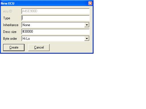

Postby New2Scoobs » Tue Apr 11, 2006 2:08 pm
Epifan, what is this screen actually asking me for when it prompts for "Type"?
