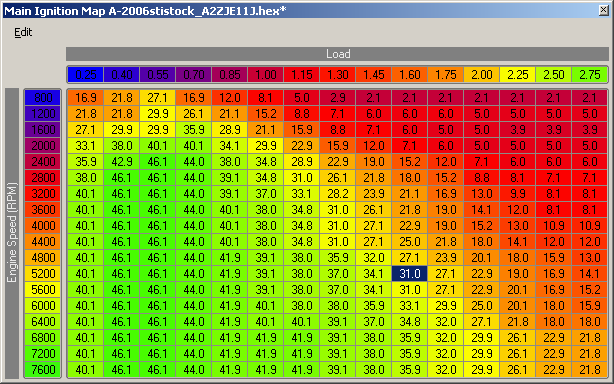

may i proudly present.....(sorry for the formatting)
MY06 STi Main Ignition map
3D MAP
Offset 7C3B0 508848
Col count:19
Col offset:000CA26C 828012
Row count:18
Row offset:000CA2B8 828088
Data offset:000CA300 828160
Data type:8bit 04000000
Data multiplier:0.3515625000000000 3EB40000
Data addition:-20.0000000000000000 C1A00000
LOAD/RPM 0.25 0.40 0.55 0.70 0.85 1.00 1.15 1.30 1.45 1.60 1.75 1.90 2.05 2.20 2.35 2.50 2.65 2.80 2.95
800.00 20.08 31.68 28.87 25.35 17.62 9.88 4.26 -1.37 -3.13 -3.13 -3.13 -3.13 -3.13 -3.13 -3.13 -3.13 -3.13 -3.13 -3.13
1200.00 29.92 41.17 38.01 34.49 30.27 19.02 12.70 8.48 4.96 1.45 -2.07 -2.07 -2.07 -2.07 -2.07 -2.07 -2.07 -2.07 -2.07
1600.00 34.84 45.74 42.23 39.41 35.90 30.27 21.84 14.80 8.48 3.55 1.80 0.04 0.04 0.04 0.04 0.04 0.04 0.04 0.04
2000.00 40.12 49.26 49.26 42.93 38.71 34.49 30.98 23.95 14.80 10.94 7.07 3.55 0.04 0.04 0.04 0.04 0.04 0.04 0.04
2400.00 49.26 49.26 49.26 46.45 43.63 40.82 33.79 26.76 21.13 15.51 9.88 4.26 0.04 0.04 0.04 0.04 0.04 0.04 0.04
2800.00 49.26 49.26 49.26 46.45 43.63 40.82 35.90 28.87 23.24 19.02 16.21 13.40 10.59 7.77 4.96 2.15 0.04 0.04 0.04
3200.00 49.26 49.26 49.26 46.45 43.63 40.82 37.30 32.38 26.05 20.43 16.91 14.10 11.64 9.88 8.13 6.37 4.61 2.85 1.09
3600.00 49.26 49.26 49.26 47.50 43.63 40.82 38.01 33.44 27.46 23.24 20.43 17.62 14.80 11.99 10.23 8.48 6.72 4.96 3.20
4000.00 49.26 49.26 49.26 47.50 43.63 40.82 38.01 33.79 28.87 24.65 20.43 17.97 15.51 13.40 11.99 10.59 9.18 7.77 6.37
4400.00 49.26 49.26 49.26 47.50 43.63 40.82 38.01 33.79 29.57 25.35 21.13 19.02 16.91 14.80 13.75 12.70 11.64 10.59 9.53
4800.00 49.26 49.26 49.26 47.50 43.63 40.82 39.77 37.66 34.49 31.33 28.16 25.35 22.89 20.43 17.97 16.21 14.45 12.70 10.94
5200.00 49.26 49.26 49.26 47.50 43.63 40.82 39.77 37.66 34.49 31.33 27.81 24.65 22.89 21.13 19.73 18.32 17.27 16.21 14.45
5600.00 49.26 49.26 49.26 47.50 43.63 41.88 40.12 37.66 35.20 32.03 28.87 26.76 25.35 23.95 22.19 19.73 18.32 16.91 15.51
6000.00 49.26 49.26 49.26 47.50 44.34 42.93 41.52 38.36 35.20 31.68 29.92 28.16 25.70 23.95 22.19 19.73 18.32 16.91 15.51
6400.00 49.26 49.26 49.26 47.50 44.34 42.93 41.52 40.12 38.71 36.60 33.44 30.27 28.16 26.05 23.95 22.19 20.43 18.67 16.91
6800.00 49.26 49.26 49.26 47.50 44.34 42.93 41.52 40.12 38.36 36.60 34.14 31.68 29.22 26.76 26.05 23.24 21.48 19.73 17.97
7200.00 49.26 49.26 49.26 47.50 44.34 42.93 41.52 40.12 38.36 36.60 34.14 31.68 29.22 26.76 26.05 23.24 21.48 19.73 17.97
7600.00 49.26 49.26 49.26 47.50 44.34 42.93 41.52 40.12 38.36 36.60 34.14 31.68 29.22 26.76 26.05 23.24 21.48 19.73 17.97

Postby Freon » Sun May 07, 2006 12:10 am
Looks good so far.
For the mult and add bytes as xswrex describes, I see lots of 3F800000 (+1.0) for the multiplier, no addition, and in those circumstances the conversion expressions already known (toIgn, frIgn, toBoostBar, etc) work.
For the axis, IEEE 754 seems to result directly in the unit of measure expected. Air load g/s, rpm, etc. require no further expression to convert the value. IEEE754 supercedes the need for any expression for axis information. A checkbox in ecuedit that disabled (grey out) the sign, mul, byte order power, etc., and disabled the value via 754 would be perfect.
edit: or just add offset to map type functionality with the supplied information.

Postby cboles » Sun May 07, 2006 1:19 am
I've added support for float and double types in EcuFlash for the next release. Here's an example for an Ignition map based on what was presented here. The scalings for the map look like this:
   <scaling name="Timing" units="degrees" toexpr="x*90/256-20" frexpr="(x+20)*256/90" format="%.1f" min="-20" max="70" inc="1" storagetype="uint8" endian="little"/>
   <scaling name="RPM" units="RPM" toexpr="x" frexpr="x" format="%.0f" min="0" max="10000" inc="50" storagetype="float" endian="little"/>
   <scaling name="Load" units="" toexpr="x" frexpr="x" format="%.2f" min="0" max="4" inc="0.05" storagetype="float" endian="little"/>

Postby cboles » Mon May 08, 2006 12:00 pm
There still needs to be endian support for floating point as well. x86 is big endian, SH2 is little. EcuFlash obeys the endian setting even when you use "float" and "double"
