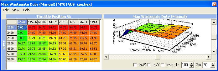

Hi
I am currently trying to workout a way to calculate the wastegate throttle percentage on a 2D map. Would anyone have a forumla that works in big endian or the a way to find out the maximum throttle value?
I am currently using the formula : [value]*100/169
When i display up the wastegate section i get the following.
Anyone able to steer me in the right direction?
Image Capture of wastegate load issues
intrawrx
Postby cboles » Sat Mar 18, 2006 7:26 am
Here are the relevant scalings from the new EcuFlash - just substitute [value] for x, and I think it should work.
      <scaling name="RPM" units="RPM" toexpr="x*50/256" frexpr="x*256/50" format="%.0f" min="0" max="9000" storagetype="uint16" endian="big"/>
   <scaling name="Throttle" units="%" toexpr="x*100/43516" frexpr="43516/100/x" format="%.2f" min="0" max="100" storagetype="uint16" endian="big"/>
   <scaling name="WGDuty" units="%" toexpr="x*100/246" frexpr="246/100/x" format="%.2f" min="0" max="100" storagetype="uint8"/>
Postby intrawrx » Sat Mar 18, 2006 6:04 pm
Colby,
You are a champ!
All nice and neat now :)

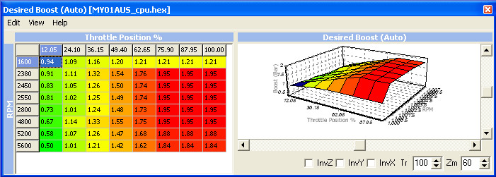

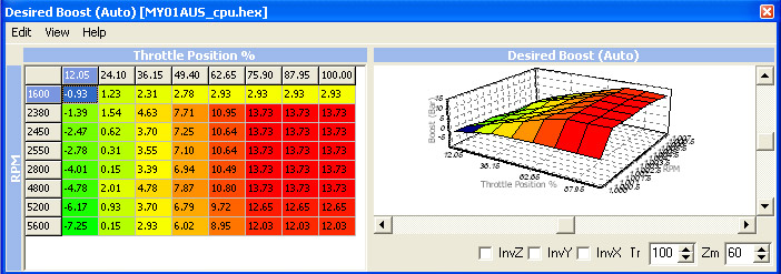

I have noticed that a few people have marked out their "Target boost" maps with "BAR targets" , if i change it to "PSI" it seems to look a little more correct.
What would be your guys opinion on this?
Boost Target in BAR
Target Boost in PSI

Postby mrtMY03Aust » Sun Apr 16, 2006 5:48 am
The BAR target's are in absolute pressure?
(ie, including the 1 atmo?)
Just a thought.
mrtMY03Aust
Joined: Tue Dec 27, 2005 8:33 am
Postby FrSTi » Thu Apr 20, 2006 12:21 pm
mrtMY03Aust wrote:The BAR target's are in absolute pressure?
Just a thought.
They are.
They include the atmo, not necessary @ 1 ;)
