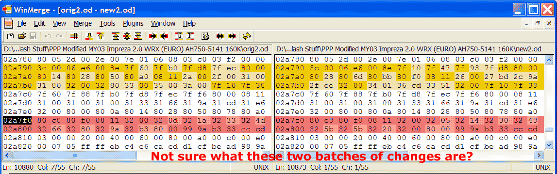

Just a quick note to bring this thread back to life. I'm still at a dead end trying to explain the differences in the illustration at the end of page one of this thread.
Can anyone help me explain these differences? Any assistance greatly appriciated :-)

Thought I would offically close this thread out as I've worked out a while ago what the odd changes were I reported much earlier in this thread. Thanks to XMLWrite being able to determine more maps for us this is what the final changes were.
The following is a copy of the original screen shot diffs that were giving me trouble decoding:

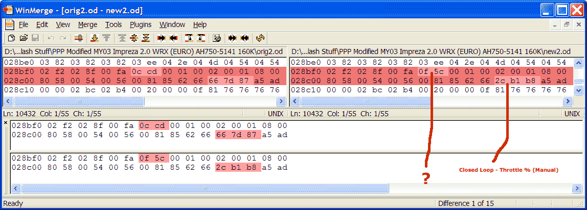

First one above (two-bytes: 05 5C) represents the Fuel Map Result Before Ramping Intead of Jumping (Lambda 0.12). I have no idea what this means.
Second one (one-byte: 2C) is the throttle % (26%) for open loop.
Third one [two-byte: B1 B8] is the Closed/Open Loop switch over (100mph and 114mph)

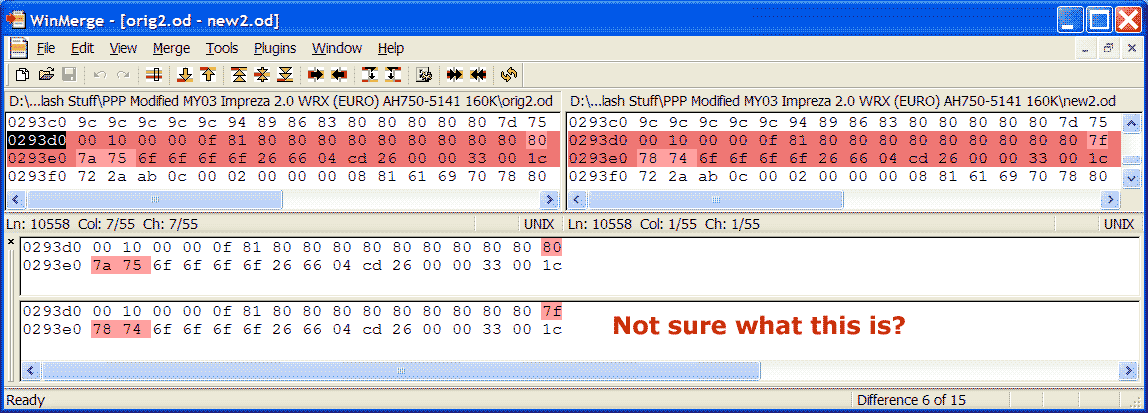

The 3-bytes (7F 78 74) changed above is slightly modifying the Ignition Intake Temp Compensation map.

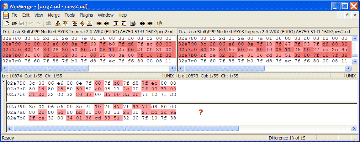

All the above changes are to the Turbo Dynamics - Proportional Continuous map.
The above changes in red are to the Turbo Dynamics - Integral Positive map - I have no idea what this does.

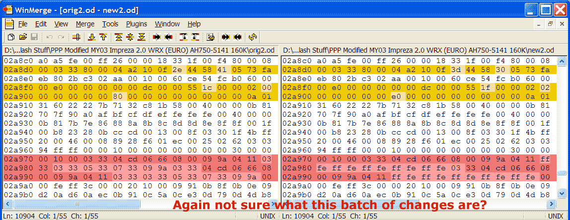

The third change here [FF's FE's] are the Cat Threshold 2 - Fail Above A & B maps - raise the limit in both instances.

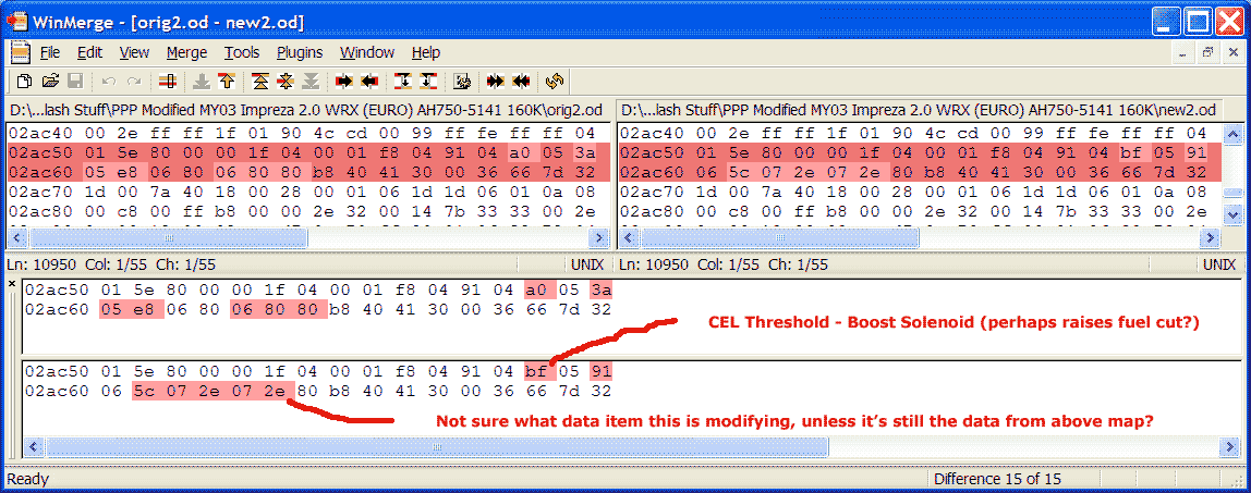

The above is a change to the Boost Solenoid CEL Map Threshold - again raising the limit.
