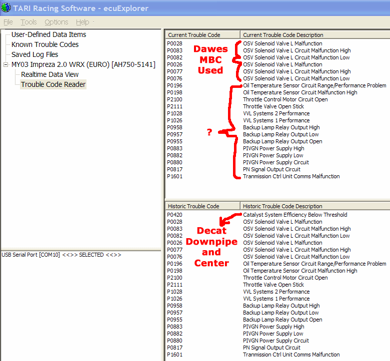

crispyduck wrote:All,
What is missing? A tool to read and reset fault codes (without ECU reset) on the Newage ECU (for me a MY03 (Euro) WRX. Does anyone know of anything available today?
Editted to add the ability to reset codes as well without resetting the ECU.
calvinc wrote:i will be adding v2.0.1 of ecuExplorer to my website (www.tari.co.za) later today. it has support to read the trouble codes and clear them. the clearing is done through an ecu reset.
enjoy...
enjoy...
what happened is that with each model year it looks as though subaru has added additional memory registers to store the dtc. older cars dont need all the known addresses queried just the earlier ones. most recent cars will obviously use all the known addresses. i'm making the change tonight and will release a new version tomorrow for more testing, it will query based on the ECU label received during the initial connection.What model is it currently based on? Just curious?
calvinc wrote:v2.0.2 available from here:
http://www.tari.co.za/cgi-bin/yabb2/YaBB.pl?num=1133944302
it now only queries the known dtc addresses based on the connected ecu type.

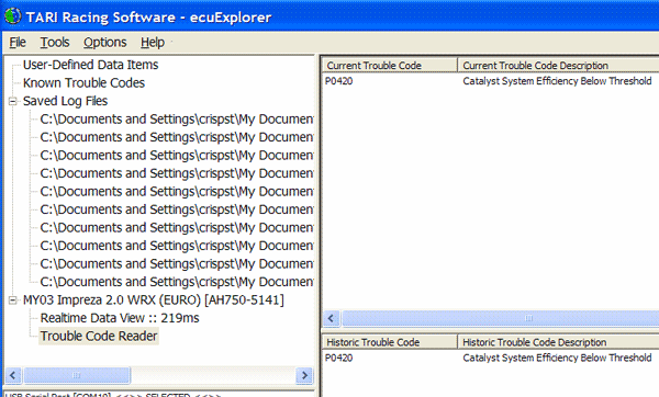

crispyduck wrote:That was quick - thanks very much. I've downloaded and installed it this morning and will give it a go on the way home tonight from work. I'll report back shortly....
