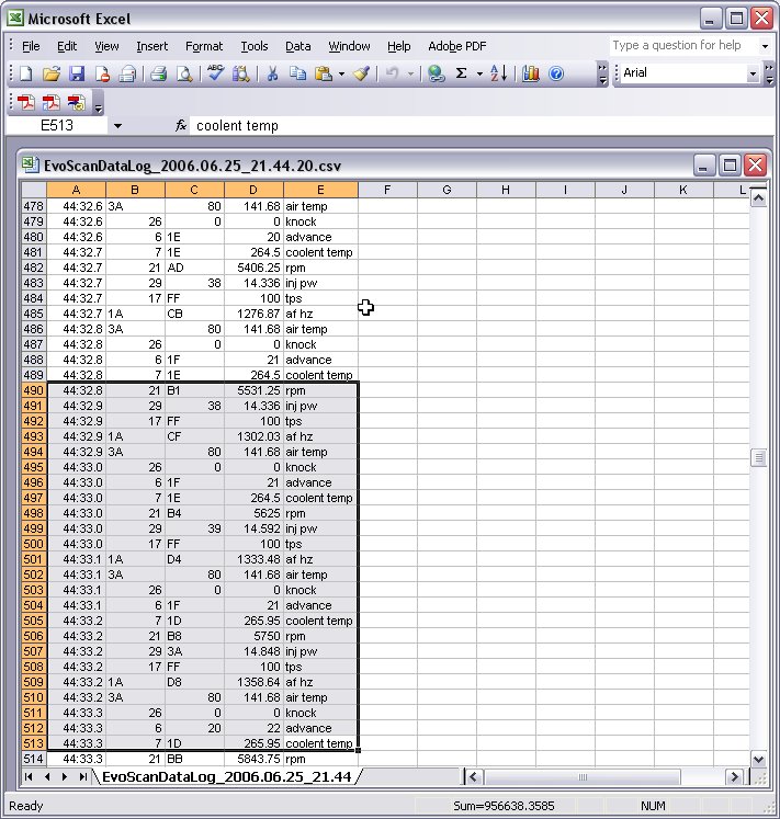

HiVoltEVO wrote:1) Timing does not seem right. It seems to be indicating too high. Maybe someone else can confirm.
HiVoltEVO
it looks like for some reason the program instead of subtracting 10 from the data received from the ecm like the formula/function indicates in the software it is adding 1 or 2 to it. If I take the data received from column C and subtract 10 then compare it to my ignition maps it looks accurate
ps I added the notes in column E myself by just pasting multiple cells repetedly

i did the same thing. compared it to my ignition maps - 10 deg and it looks about right. i would love to see load also, just to help me tune a little easier

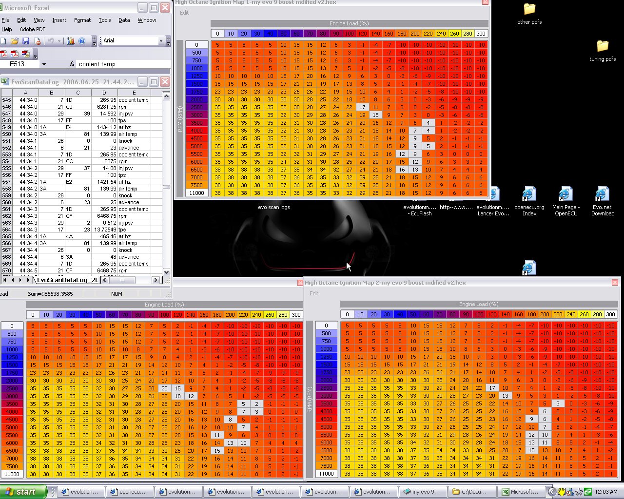

just for giggles here is a shot of all 3 high octane maps It looks like my car was running through either map 1 or 2 or quite possibly both
note: this car is completly stock, the only changes made were to set boost limit to 255 and set boost desired engine load #2 at 159.4 across the board. it now spikes 1.3 bar @ approx 3300 holds 1.25 bar till approx 5500-5700 and gradualy tapers from there

throttle position and load #s are very diferent numbers. load is a number calculated by the ecm based on manifold pressure, tps, temp, maf hz, and other factors to estimate the engines volumetric efficency if you notice in my picture above the highlited areas on each ignition map are load/rpm plots on the map my timeing passed through on one pulland the load changed signifigantly around 3000 rpms that whole plot was 100% tps
haveing the actual load # that the ecm is useing logged would be an incredible aid to tuners
