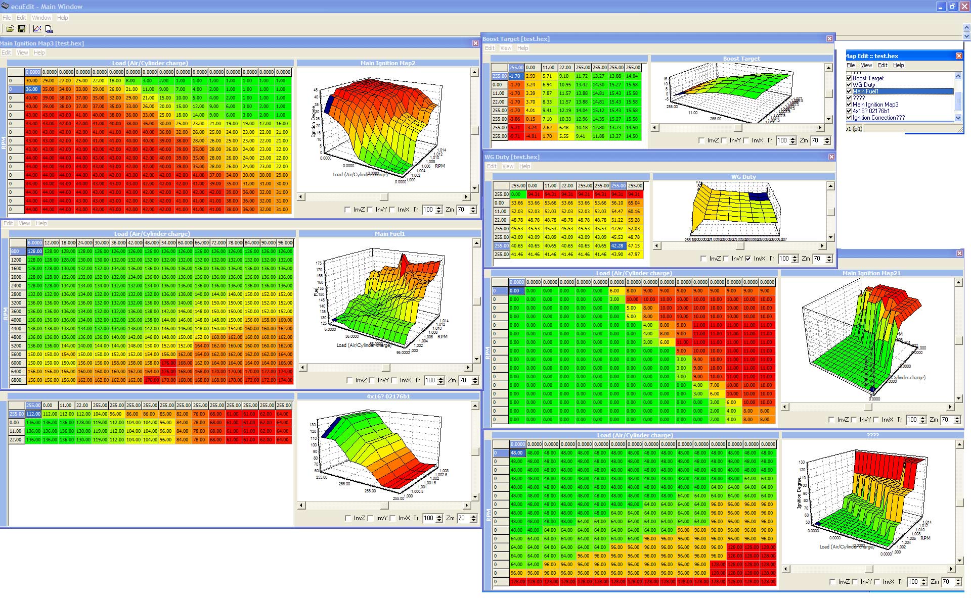

Postby Hitokiri » Wed Mar 29, 2006 5:34 am
ok I threw some more maps I found up there.
There are for sure way more in there as I haven't started playing with 2 byte data in there. I can't seem to find the axis scaling for the boost and WG maps, but it was cool to see that the map data for the boost target and WG target maps seems to use the same data conversion from hex as the Denso maps. I am almost 100% sure that those maps are right.
STi6, the data you saw at 0x1b2d seems to be axis information for the map which follows it. You can see this map in my pic below in the lower right with the steps in the data. The axis information seems to go 0-255 and 0-240 on this map. I didn't put it on there as Im not sure what it is..
The map directly above that I named "Main Ignition Map21" is a little confusing. I am not sure what we are looking at there. I though it might be some kind of ingition learning, but I'm not sure about that at all. Disassembly with show the truth.
More map exploration with JECS
