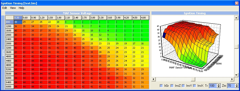

Postby west_minist » Thu Apr 06, 2006 7:56 pm
First, I do not know what year this ECU is and if STI, so I am assuming wrx.
Don't know if it looks right, but base on my JDM 2000 ECU stats, I feel the load is the MAF voltage.
Ignition Map.jpg (247.38 KiB) Viewed 12778 times

Postby x99percent » Fri Apr 07, 2006 6:33 am
west_minist wrote:First, I do not know what year this ECU is and if STI, so I am assuming wrx.
E**Tek shows load as g/sec of air. This value can be close to (but isn't the same as) the MAF voltage.

Postby west_minist » Fri Apr 07, 2006 6:37 am

Postby x99percent » Fri Apr 07, 2006 11:55 am
west_minist wrote:So, any idea what the loads variables look like?
http://195.112.37.59/products/deltaecu/ ???
In DeltaDash, there is an "Engine Load" parameter that you can monitor, which is obviously related to, but is not the same as, MAF voltage.
