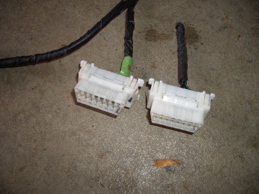

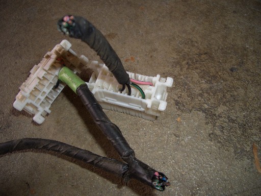

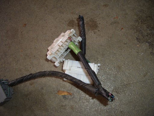

I have these obd2 connectors that might help any of you guys that are doing bench testing.
$10 shipped.
sales@rdtech-online.com
They are from various obd2 cars so they may need to be repin for subaru applications. They may also be missing wires in certain pin outs. Thats why i'll include two of them if the wires are not complete on one. That way you can take them out and rearrange the pins.
This should help those that are doing bencht testing.
My bench testing is almost complete.
thanks
