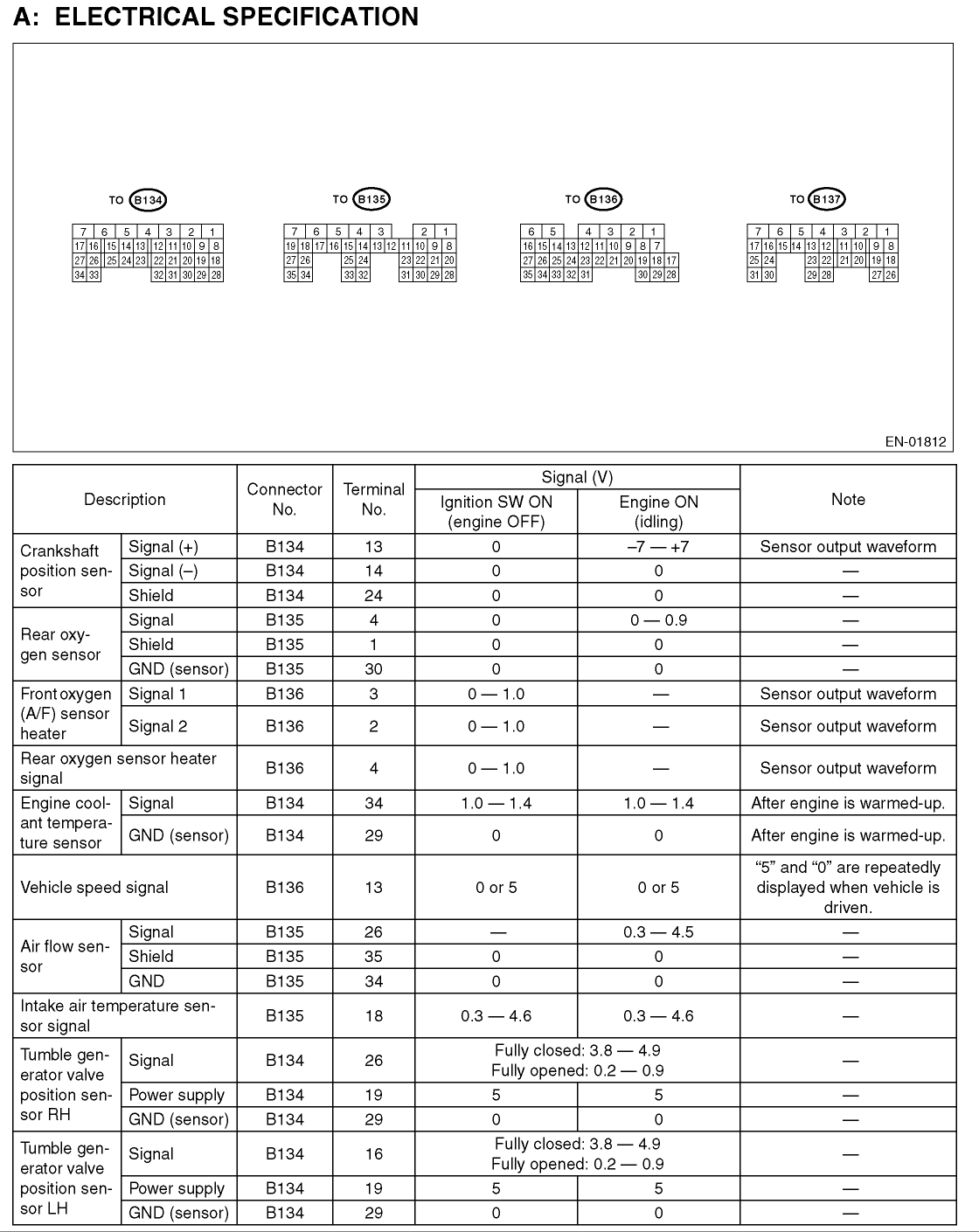

This is my first post, so I'd like to apologise if it's in the wrong place. Before I start mapping etc I'm wanting to hook up some gauges. The 2nd is a Defi Link Display. To make it function correctly, it needs the Vehicle Speed Signal from the ECU.
Does anyone have a 2007 WRX ECU Diagram? Or pinout?

Here is that info for you.
Absubtle
CO
07 WRX ECU pinout.gif (54.84 KiB) Viewed 2598 times

Thank you very much
