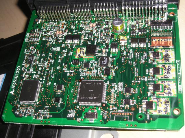

What processor is in the Evo 5/6? Can you read the numbers off of the CPU, give me the pin count, and tell me which pins the crystal is connected to (and also the crystal frequency)? Some pictures of the PCB would be useful also.
Postby GTODesign » Sun Jan 29, 2006 8:09 am
MH7202F Renesas chip on the E5/6.
E6 PCB pic...

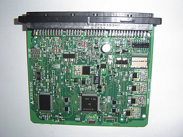

Forgive my ignorance (I'm still learning here :D ) but I assume the crystal is the silver item with the yellow label near the plug?
E5 PCB

Looks to be from the H8/500 series. A H8/539F (128k flash), I believe. Different processor core than the newer EVOs which use SH-2. I would have to write a new kernel for this car.
Postby cboles » Sun Jan 29, 2006 10:19 am
you can see links to these old datasheet here, but they are nowhere on the Renesas site anymore.
http://technsys.com/hitachi/line_up/h8500_lineup.htm

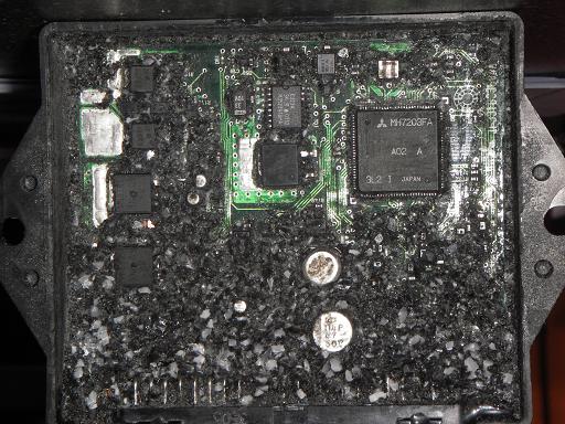

This ECU is in a MY2005 Kawasaki jetski (I think it is common to all Kawasaki). I'm just cleaning all the board right now ... just know the reference and then will need to count for pins and find oscillator.
Colby, let me know if you have any experience or material for this UC ;)

UC is 28 pins by side, as in evo 5/6. Hope that even if reference is not exactly the same, I will find some common parts !!
I'm looking for an ISP connector on this board and still cleaning to find oscillator.
Postby NeverLies » Mon Jan 30, 2006 7:52 am
Here is what the board looks like right now, no ISP found right now.
UC board
